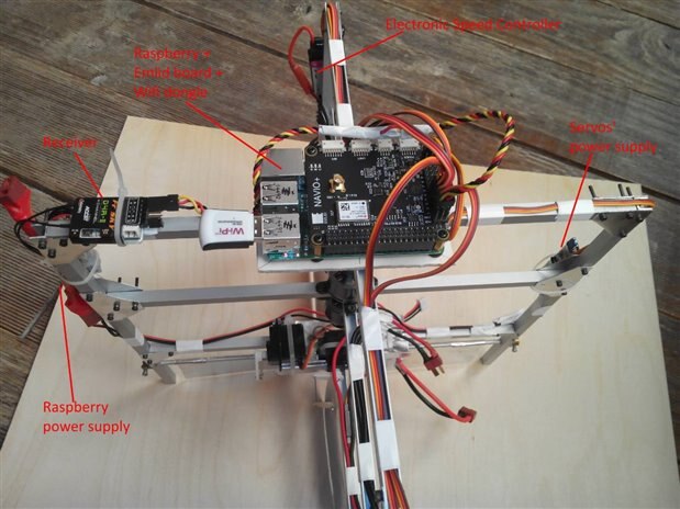

Today I completed the wiring of the TrainingSphere. The final result is shown in picture
As you can see, I finally made the decision the use the Emlib Navio+ board. This is a really challenging project I want to continue to develop even after the end of this design challenge, so I invested some  money in a piece of hardware that is reliable and tested enough to make me develop applications that run in the Raspberry environment and interact with the APM platform. Possibilities are really endless compared with "closed" solutions like pixhawk and ardupilot
Anyway, next steps will include
1. Parameters settings
2. Compass calibration
3. Accelerometer calibration
4. Radio calibration
and finally... first flight (hoepfully)
After that, the plan is the add the optical flow sensor for making the sphere able to loiter in an indoor enviroment

    Very tidy, using the spaces in the aluminum frame for cable management is a great idea. It looks very clean!

    amgalbu over 11 years ago in reply to screamingtiger
    Yes, it's available here
    http://docs.emlid.com/Downloads/Real-time-Linux-RPi2/
    BTW, I initially wanted to use the Raspberry Pi board, but the image provided does not boot at all. Don't know why...

    Real time Raspian, didn't you have to install it for your project?
  • amgalbu
    Sorry, I'm not with you.  Which image are you talking about?
  • screamingtiger
    screamingtiger over 11 years ago in reply to amgalbu
    I am not seeing an image for Raspberry Pi 2....
    Did you find one?
  • screamingtiger
    LOL I should of just bought the Navio board.  Its basically what I made with the raspberry pi and chipkit pi.
