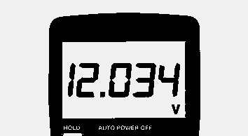

Experimenting with Multimeter Image
I already discussed about the preprocessing of an image before OCR. Now, lets do the experiment with the practical image. Before trying with the actual image taken by my Raspberry Pi I want to do the experiment on some sample image of multimeter and weight scale collected from the internet. Lets first start with the multimeter image. Below are the two sample image I have chosen for the experiment.
image image
My target is to convert the voltage reading from the images to text using OCR. Consider left image as m1.jpg and right image as m2.jpg. Lets try to find the text from the above images without any preprocessing. I am using tesseract OCR engine from command line and following image shows the result I found:
From the above image it is clear that I did not find any text from left image, but for right image tesseract was able to detect some text from meter body, not the actual reading on which we are interested.

After making the image black and white I run the OCR engine again but there was no improvement on the result for left multimeter image.
Same happens with the right image. This happens maybe for the big black border around the text. So, lets cut the border using the Photoshop. This is the image after removing the black border:
After removing the border I run the OCR engine again using same configuration.
After removing the border I got an interesting result. The value is correct without the first 1. I am not sure about this behavior, maybe the font is too big. So, I added some white border and tested the image again with OCR.
Finally, I got the expected output from the OCR.
So final result came out after following this sequential steps:
Binarization of the image -> removing the black border -> adding a white boarder -> Tesseract OCR
