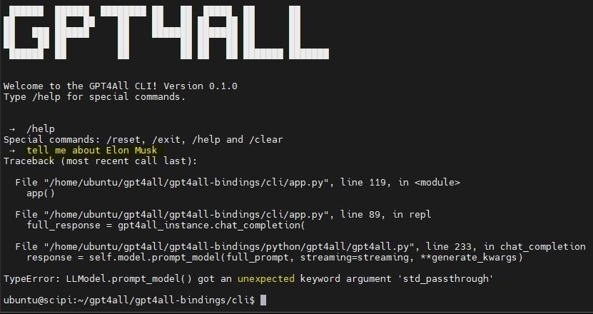

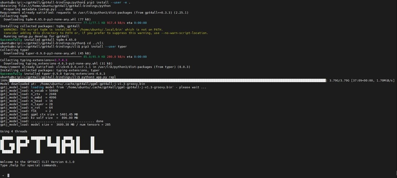

First, I've found an issue in the gpt4all project, related to running gpt4all from the command line interface (CLI). Than one of the project contributors with the username cosmic-snow provided there a script to run gpt4all from CLI.
And it was working for me all the way till the last command.
I've entered prompt and right away got an answer. But this time it was an error message.
I went back to the project issue thread and provided my feedback and a call for help..
Here I've got luckky again. cosmic-snow provided a response with details how to fix the issue the same day!
And his fixed worked well for me.
