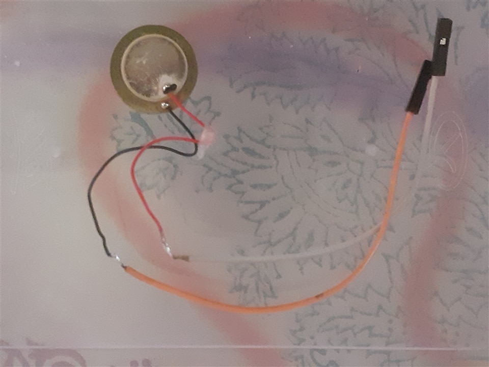

I am using this buzzer with arduino mkr Wifi 1010 but it is only vibrating and not generating any sound. I have connected the buzzer to pin no 6 that is generating 1k square wave frequency and the other terminal of the buzzer is connected to ground. I wan't to know why it is not generating any sound but it is only vibrating. Bellow is the image of the buzzer.

    Most likely , this buzzer will need an AC signal at its resonance frequency. Is it a 1 KHz device? Is your output 1 KHz? Because vibrations are usually felt in a Hz range. You will not feel 1 kHz vibrations…
    Jan Cumps over 1 year ago in reply to manojroy123 +2
    Why don't you check basics? What's the frequency?

    Is there any example video or any datasheet that can guide me.

    https://projecthub.arduino.cc/SURYATEJA/use-a-buzzer-module-piezo-speaker-using-arduino-uno-cf4191
    https://www.youtube.com/watch?v=gj-H_agfd6U&ab_channel=ScienceBuddies
    Make sure the piezo contacts are not shorted together.
