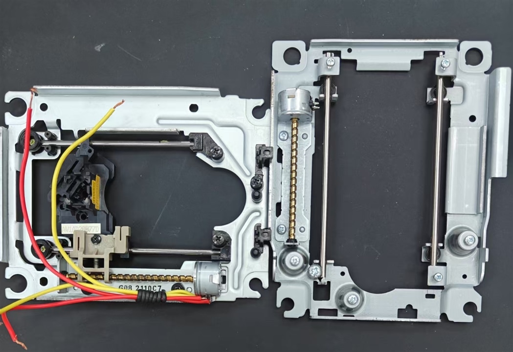

3 Parts from Old DVD Player
Here is the frame got from two DVD players
Core Idea
DVD players contain high-precision stepper motors (for disc rotation and laser tracking) and linear guides (for moving the laser assembly). These components can be salvaged and adapted to build a low-cost CNC machine, in this case a 3-axis  plotter as the starter. It can be revised to router or mill.

      But I remove them for now.

    This would be best for laser engraver and I would start from small plotter.
    Thera are still many modification for the design to make it work.
