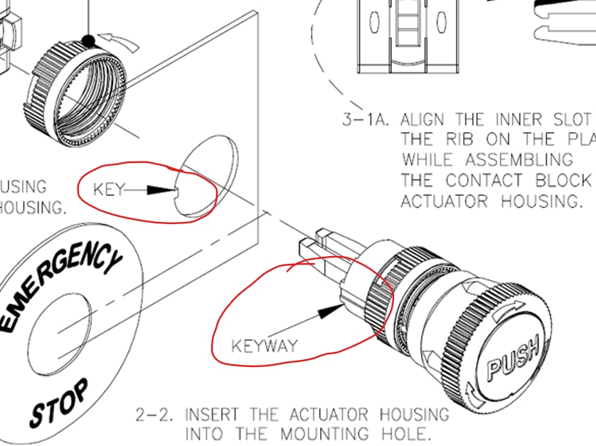

I wan't to complain about emergency stop switch ?
The emergency stop switch automatically gets removed from it's place because of thread and nut design system. We heavily use stop switch for our application it is getting removed from it's place. Please use proper design than using thread and nut design for emergency stop switch.
  • beacon_dave
    beacon_dave over 1 year ago +3
    Can you show us a photograph showing your assembly and the key in your panel cut out.

    beacon_dave over 1 year ago in reply to manojroy123 +2
    The same way as you would be expected to mount a toggle switch to a drilled front panel. Drill a small hole for the tab and place the washer behind the panel. The switch hole now has an anti rotation…
  • manojroy123
    manojroy123 over 1 year ago in reply to beacon_dave
    I don't have key for keyway in my aluminum panel. I can't make one either. You should make better solution than giving a keyway.

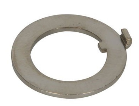

    Perhaps use a key lock washer then...

    Please share a video of how to use key lock washer as I can't find it on youtube or in google search of using it in an application.

    You just drill a second tiny hole next to your main hole, for that little right-angle protrusion to sit inside.
    There's other techniques too (e.g. if the panel is not brittle, then you could use a center-punch to make a little dimple at one point near the circumference of your large hole. It deforms the hole so it's no longer circular.
    Or use epoxy glue as part of your solution. Or a dozen other ways : )
    Drill a small hole for the tab and place the washer behind the panel. The switch hole now has an anti rotation key to prevent the switch from rotating in the hole.
  • manojroy123
    Thanks guy's. I will implement it tomorrow on the project.
