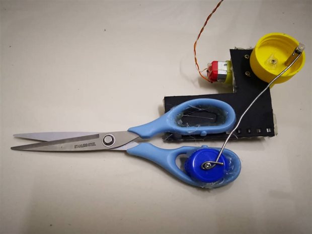

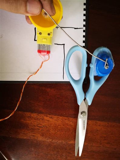

Due to really lack of time, rush out this simple motorized scissor
first, i cut out a L shaped holder from old table calendar cardboard. it is hard enough and easier to work with
After that, i glue the scissor to the L-shape holder. well i could have attached it with screw, but...to save time, glue is useful
And this is the video that it is in operation. i do find that it needs at least 5V to operate properly. At 3V, it cannot move
From the power supply, we can also see that it needs 0.3A with load (compared to 0.1A during my testing load free)
was originally thinking to put the magnetic sensor to detect the position of the scissor (either open or close) but let me do that last minute now it is to do system integration
putting everything together.

    With a scissor you will need to have a program sequence where the unit opens the scissor, drives 3 inches, closes the scissor and then repeats the process. Good proof of concept.

    Now i am kinda rethink of the benefits of having access to many gears, a CAD + CAE for modeling and 3D printer to design precisely the mechanical mechanism

    weiwei2 over 7 years ago in reply to DAB
    you are right. in fact i have a bigger circle half prepared but due to time constraint, put aside first as this scissor can minimally cut for now image
    But it is definitely something i want to improve after i complete all other pending stuff
