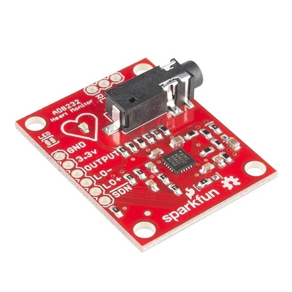

The AD8232 SparkFun Module
The AD8232 SparkFun Single Lead Heart Rate Monitor is a cost-effective board used to measure the electrical activity of the heart. This electrical activity can be charted as an ECG or Electrocardiogram and output as an analog reading. ECGs can be extremely noisy, the AD8232 Single Lead Heart Rate Monitor acts as an op amp to help obtain a clear signal from the PR and QT Intervals easily.

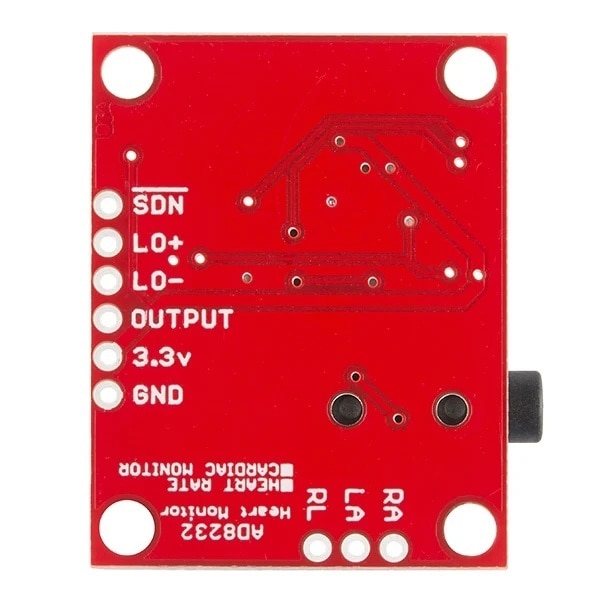

The AD8232 Heart Rate Monitor breaks out nine connections from the IC that you can solder pins, wires, or other connectors to. SDN, LO+, LO-, OUTPUT, 3.3V, GND provide essential pins for operating this monitor with an Arduino or other development board. Also provided on this board are RA (Right Arm), LA (Left Arm), and RL (Right Leg) pins to attach and use your own custom sensors. Additionally, there is an LED indicator light that will pulsate to the rhythm of a heart beat. Biomedical Sensor Pads and Sensor Cable are required to use the heart monitor.

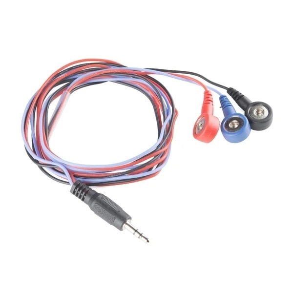

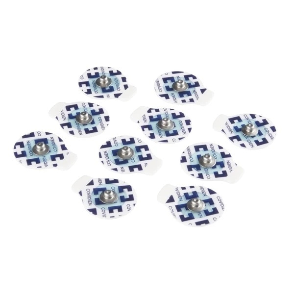

I used the following Cable and Pad with the sensor module.

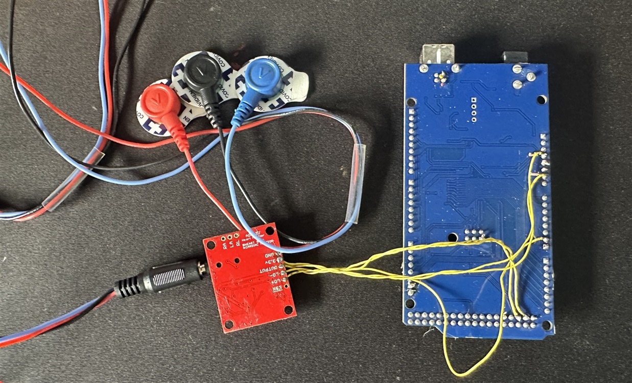

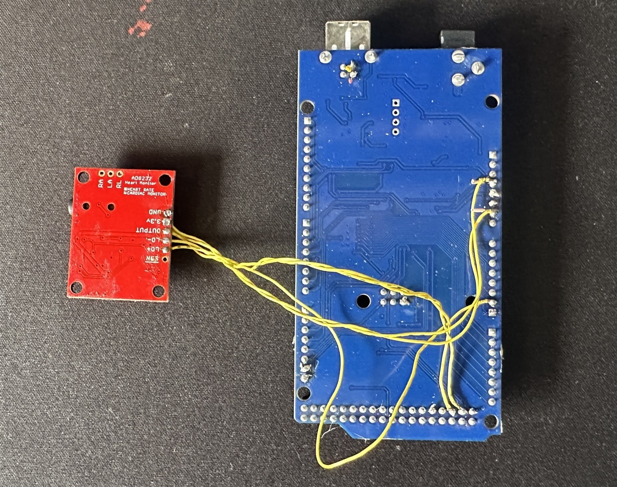

For primary testing, I used an Arduino Mega board, and the sensor connections to the Arduino board are shown in the following image. I used thin jumper wires to solder the sensor module to the Arduino board.
The following connection is made:
I connected five of the board's nine pins to your Arduino. The five pins you need are labeled GND, 3.3v, OUTPUT, LO-, and LO+
Board Label Pin Function Arduino Connection
GND Ground GND
3.3v 3.3v Power Supply 3.3v
OUTPUT Output Signal A6
LO- Leads-off Detect - 48
LO+ Leads-off Detect + 50
SDN Shutdown Not used

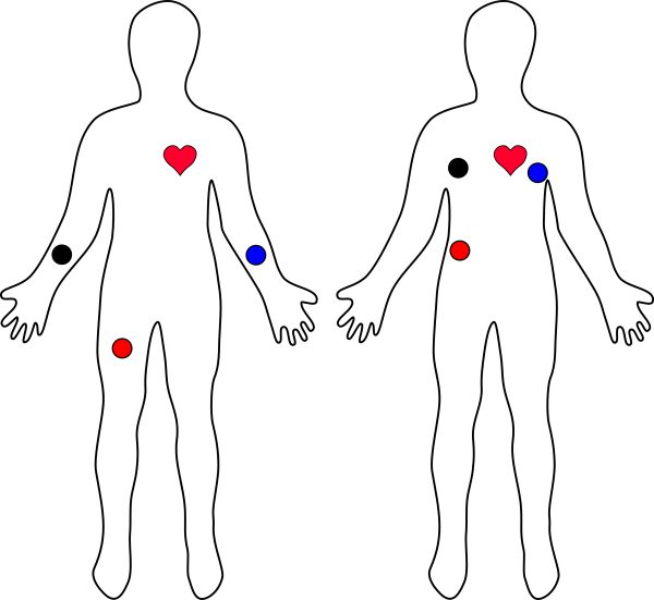

Sensor Pad Placement
The sensor placement was performed according to the SparkFun recommendation.
The closer to the heart the pads are, the better the measurement. The cables are color-coded to help identify proper placement as shown in the table based on Einthoven's triangle. The sensors can be placed on the forearms and leg as shown on the diagram on the left. Or they can be placed on the chest near the arms and above the right, lower abdomen (i.e. just above the right hip) as shown on the diagram on the right.
Cable Color Signal
Black RA (Right Arm)
Blue LA (Left Arm)
Red RL (Right Leg)

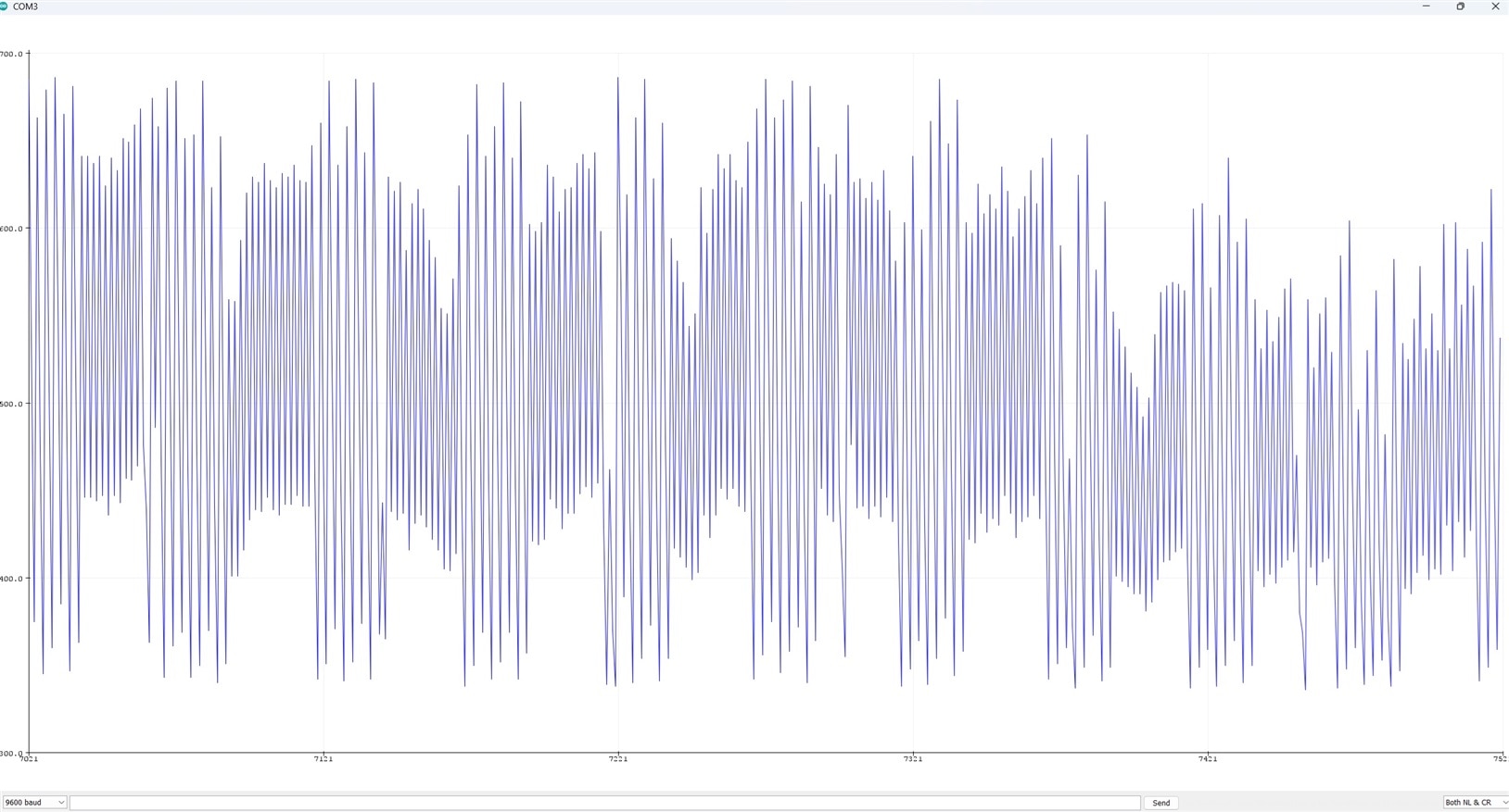

I got the following result from the Arduino Serial Plotter. Maybe it needs some adjustment in the code for a clean graph.
