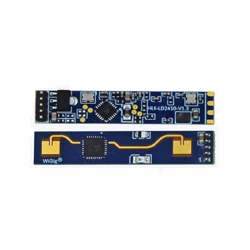

The Radar (HLK-LD2410)
(Primarily this is the one I am using.)
I would also like to share the part of the journey of making it, though I had not used it, finally, because it was really terrible.
Firstly I tried training the model but in the future I will see that it will become a terrible waste of time.

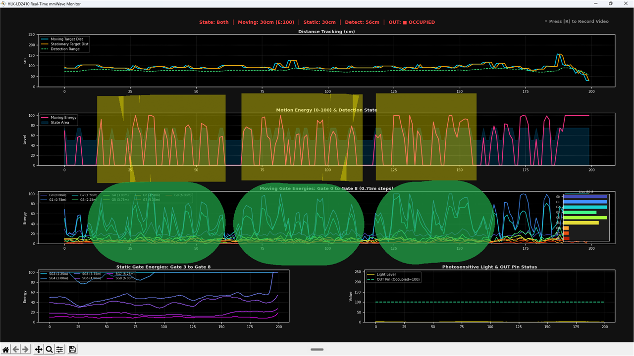

The real algorithm
After the failure in creating the impulse, I had to work on the algorithm.
In order to create the algorithm first, I have to look for patterns while I'm breathing from the data. The best way a human can do that is visually. So I looked at the visual data.
I recorded the data. Keeping in mind that it detects breathing while sleeping, I made as minimalist a movement as possible to detect only the movement of breathing, along with the background noise (as it will be there while sleeping also). I captured it and after staring at it for a while, I noticed some patterns.
So as you can see, while breathing we also inhale and exhale and the duration while we do that at the peaks is not that much different. In between the zeroth values, while we are moving towards the next breathing process, there is a noticeable difference that we can use to detect the n number of breaths.
 And we can also see the wave format in the crust, in the gate energies. By that  we can also detect the intensity and the distance and as per the distance we can also get the accurate value of breaths per minute.
And the code was very long because we have to manage the communication especially too and also while plotting it all and showing all the graphs. After implementation the code I developed was fairly long, I think really long. I won't be able to write it without using AI and I think if I do I will need a week or two.If you want to take a look at it, you can see it below.

STATE_LABELS = {0: "No Target", 1: "Moving", 2: "Static", 3: "Both"}
STATE_COLORS = {0: '#555555', 1: '#00ccff', 2: '#ffaa00', 3: '#ff4444'}
if DARK_BG:
    plt.style.use('dark_background')
fig = plt.figure(figsize=(15, 9.5), facecolor='#111111' if DARK_BG else '#f5f5f5')
fig.canvas.manager.set_window_title('HLK-LD2410 Real-Time mmWave Monitor & Breath Counter')
gs = GridSpec(4, 2, figure=fig,
              left=0.06, right=0.97,
              top=0.92, bottom=0.075,
              hspace=0.52, wspace=0.30)
ax_dist   = fig.add_subplot(gs[0, :])    # distances — full width
ax_moven  = fig.add_subplot(gs[1, :])    # moving energy + target state + breath
ax_movg   = fig.add_subplot(gs[2, :])    # per-gate moving energies MG0–MG8
ax_stag   = fig.add_subplot(gs[3, 0])    # static gate energies SG3–SG8
ax_misc   = fig.add_subplot(gs[3, 1])    # Light + Output pin
def style_ax(ax, title, ylabel='', ylim=None):
    ax.set_title(title, fontsize=9.5, pad=3, fontweight='bold',
                 color='#dddddd' if DARK_BG else '#222222')
    ax.set_ylabel(ylabel, fontsize=8)
    ax.tick_params(labelsize=7.5)
    ax.grid(True, alpha=0.25, linestyle=':')
    if ylim: ax.set_ylim(ylim)
style_ax(ax_dist,  'Distance Tracking (cm)',            'cm',     (0, 700))
style_ax(ax_moven, 'Motion Energy (0-100) & Breath Detection (Algorithm 1)', 'Level',  (0, 105))
style_ax(ax_movg,  'Moving Gate Energies: Gate 0 to Gate 8 (0.75m steps)', 'Energy', (0, 105))
style_ax(ax_stag,  'Static Gate Energies: Gate 3 to Gate 8', 'Energy', (0, 105))
style_ax(ax_misc,  'Photosensitive Light & OUT Pin Status', 'Value')
x_data = list(range(HISTORY))
# ── Distance plot lines ──
line_movdist, = ax_dist.plot(x_data, [0]*HISTORY, color='#00d4ff', lw=1.5, label='Moving Target Dist')
line_stadist, = ax_dist.plot(x_data, [0]*HISTORY, color='#ffaa00', lw=1.5, label='Stationary Target Dist')
line_detdist, = ax_dist.plot(x_data, [0]*HISTORY, color='#44ff88', lw=1.2, ls='--', label='Detection Range')
ax_dist.legend(fontsize=7.5, loc='upper left', framealpha=0.35)
# ── Motion energy + state lines + breath detections + baseline ──
line_moven, = ax_moven.plot(x_data, [0]*HISTORY, color='#ff3388', lw=1.6, label='Moving Energy')
bar_state   = ax_moven.fill_between(x_data, 0, [0]*HISTORY, alpha=0.18, color='#00aaff', label='State Area')
line_baseline = ax_moven.axhline(
    y=SAMPLE_BASELINE, color='#ffee00', linestyle='--',
    linewidth=1.3, alpha=0.85, label=f'Baseline ({SAMPLE_BASELINE:.0f})', zorder=4
line_breaths, = ax_moven.plot([], [], 'o', color='#00ffff', markersize=7.5,
                             markeredgecolor='#ffffff', markeredgewidth=1.2,
                             label='Breath Peak Detected', zorder=5)
ax_moven.legend(fontsize=7.5, loc='upper left', framealpha=0.35)
# Breath detection HUD badge on ax_moven
breath_hud = ax_moven.text(
    0.985, 0.88, '[Breath] Initializing...',
    transform=ax_moven.transAxes, ha='right', va='top',
    fontsize=9.0, fontweight='bold',
    color='#ffaa00',
    bbox=dict(boxstyle='round,pad=0.38', facecolor='#151c28' if DARK_BG else '#ffffff',
              edgecolor='#ffaa00', alpha=0.9, lw=1.2)
# ── Moving gate energies MG0–MG8 ──
MOVG_COLORS = plt.cm.turbo(np.linspace(0.08, 0.92, MAX_GATES))
movg_lines  = []
for i in range(MAX_GATES):
    ln, = ax_movg.plot(x_data, [0]*HISTORY,
                       color=MOVG_COLORS[i], lw=1.2,
                       label=f'G{i} ({i*GATE_DIST_M:.2f}m)')
    movg_lines.append(ln)
ax_movg.legend(fontsize=6.5, loc='upper left', framealpha=0.35, ncol=5)
# ── Static gate energies SG3–SG8 ──
STAG_COLORS = plt.cm.cool(np.linspace(0.15, 0.95, 6))
stag_lines  = []
for j, i in enumerate(range(3, 9)):
    ln, = ax_stag.plot(x_data, [0]*HISTORY,
                       color=STAG_COLORS[j], lw=1.2,
                       label=f'SG{i} ({i*GATE_DIST_M:.2f}m)')
    stag_lines.append(ln)
ax_stag.legend(fontsize=6.5, loc='upper left', framealpha=0.35, ncol=3)
# ── Light & OutPin ──
line_light,  = ax_misc.plot(x_data, [0]*HISTORY, color='#ffee33', lw=1.3, label='Light Level')
line_outpin, = ax_misc.plot(x_data, [0]*HISTORY, color='#33ffaa', lw=1.6, ls='--', label='OUT Pin (Occupied=100)')
ax_misc.set_ylim(0, 260)
ax_misc.legend(fontsize=7.5, loc='upper left', framealpha=0.35)
# Inset horizontal snapshot bar chart for moving gates
bar_ax = ax_movg.inset_axes([0.91, 0.05, 0.08, 0.90])
bar_ax.set_xlim(0, 105)
bar_ax.set_ylim(-0.5, MAX_GATES - 0.5)
bar_ax.set_yticks(range(MAX_GATES))
bar_ax.set_yticklabels([f'G{i}' for i in range(MAX_GATES)], fontsize=6)
bar_ax.set_xticks([])
bar_ax.set_title('Live G0-8', fontsize=6.5, pad=2, color='#cccccc' if DARK_BG else '#333333')
bar_ax.invert_yaxis()
if DARK_BG: bar_ax.set_facecolor('#1c1c1c')
bars = bar_ax.barh(range(MAX_GATES), [0]*MAX_GATES, color=MOVG_COLORS, height=0.65)
# Top status header text
status_txt = fig.text(0.5, 0.965, 'Connecting…', ha='center', va='top',
                      fontsize=10, fontweight='bold',
                      color='#aaffaa' if DARK_BG else '#008800')
# Global background reader
reader = None
# Bottom interactive Slider for live Breath Baseline Noise Floor adjustment
slider_ax = fig.add_axes([0.22, 0.015, 0.56, 0.024], facecolor='#202020' if DARK_BG else '#e8e8e8')
baseline_slider = Slider(
    slider_ax, 'Breath Baseline (Noise Floor):',
    0.0, 70.0, valinit=SAMPLE_BASELINE, valstep=1.0,
    color='#00ffcc',
    initcolor='none',
    track_color='#141414' if DARK_BG else '#cccccc'
baseline_slider.label.set_color('#dddddd' if DARK_BG else '#222222')

As it is fairly long it won't be feasible to explain it all so I will be explaining it in short. This is in Python and it's also good in that, on the Linux side, I can use it with some modification.
The clock
The ESP32 prints one row every 50 ms, so the sample rate is 20 Hz and each sample is Δt = 0.05 s. The Python side works in samples, so converting between samples and seconds is the maths you’ll use most:
time = samples × 0.05 s        samples = time × 20
Step 1: the start signal (arming)
The counter sits in WAITING until E ≥ 100 continuously for 3 s. That’s 3 × 20 = 60 consecutive samples at 100. In practice you wave your hand in front of the sensor, which saturates the energy. If E drops below 100 even once, the timer resets. When the 3 s is met, it enters COUNTING with count = 0. The idea is that you tell the system “I’m now lying still, start counting” without touching the PC.
One detail: right after arming, waiting_to_clear_trigger stays true until E drops below 100. Without it, your starting wave would immediately look like a stop signal.
Step 2: turning energy into silence and motion
This is the core of it. Pick a baseline B (default 15, adjustable with the slider). Every sample is classified as:
E[k] > B   → motion
E[k] ≤ B   → silence
A running counter z tracks how many silent samples in a row you’ve seen. Any motion sample resets it to 0, and any silent sample adds 1.
Step 3: counting a breath
A new breath is counted when two things are true at once:
E[k] > B      (motion just appeared)
z ≥ G         (it was preceded by at least G silent samples)
G is MIN_ZERO_GAP. After a count, an in_breath flag stays on until a long enough silence passes, so one breath that wobbles up and down doesn’t count twice. In words: a breath is a burst of motion that comes after a proper pause.
Step 4: the rate
When a breath is counted, the code measures the time since the previous one, Δt_b, and ignores it unless 1 s ≤ Δt_b ≤ 15 s:
BPM = 60 / Δt_b
For example, a breath every 4 s gives 60/4 = 15 BPM, which is a normal resting rate. A period of 4 s is 80 samples, so a normal breath is roughly 80 samples long and the silent gap is a fraction of that.
Step 5: the stop signal
Wave again until E ≥ 100 for 3 s and the state flips to STOPPED, freezing the final count. If you hold 100 for 3 s again, it re-arms and starts a fresh session. While E ≥ 100 inside a session, samples are not counted as breaths, so the stop wave isn’t counted as breathing.

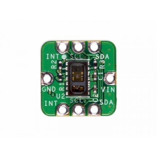

 The BPM and SPO2 Sensor ( MAXREFDES117)
It is fairly tiny compared to how it looks here.
The process of using this was fairly easy as they provide all the resources and the design files. I just needed to alter some specifications, like the pins for the I2C communication, according to my need and I am also testing this on the ESP32. For simplicity I had removed the other part of the original code so it includes some kind of adafruit, things that I don't need, so I had removed. Also the way it works is quite simple. Firstly there are two LEDs: one is IR and one is red. They emit light and there is also a sensor to detect them. The light that gets reflected back from the object, or your finger, or the skin, by that reflection, we measure the SpO2 and the BPM.
This is the sketch I used with the algorithm. I had just modified it a little bit from the original code I got from the design files.
