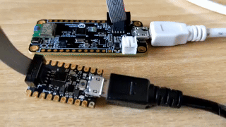

 Connecting the Boards
To begin the setup:
  • The MAX32625PICO is connected to the Analog Devices MAX32630FTHR using the provided socket-to-socket connector cable
  • Both boards are then connected to the computer using USB cables (included in the kit)
 This setup allows the PICO board to act as a programmer for the main board.

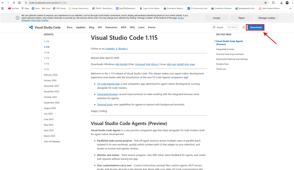

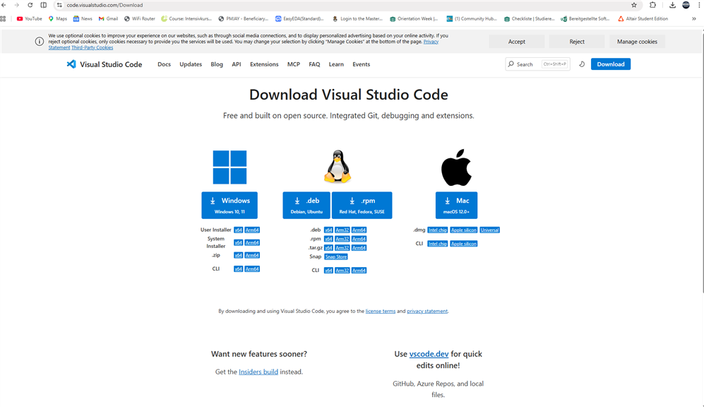

Step 1: Install VS Code
  • Install Visual Studio Code (if not already installed). Link : https://code.visualstudio.com/Download

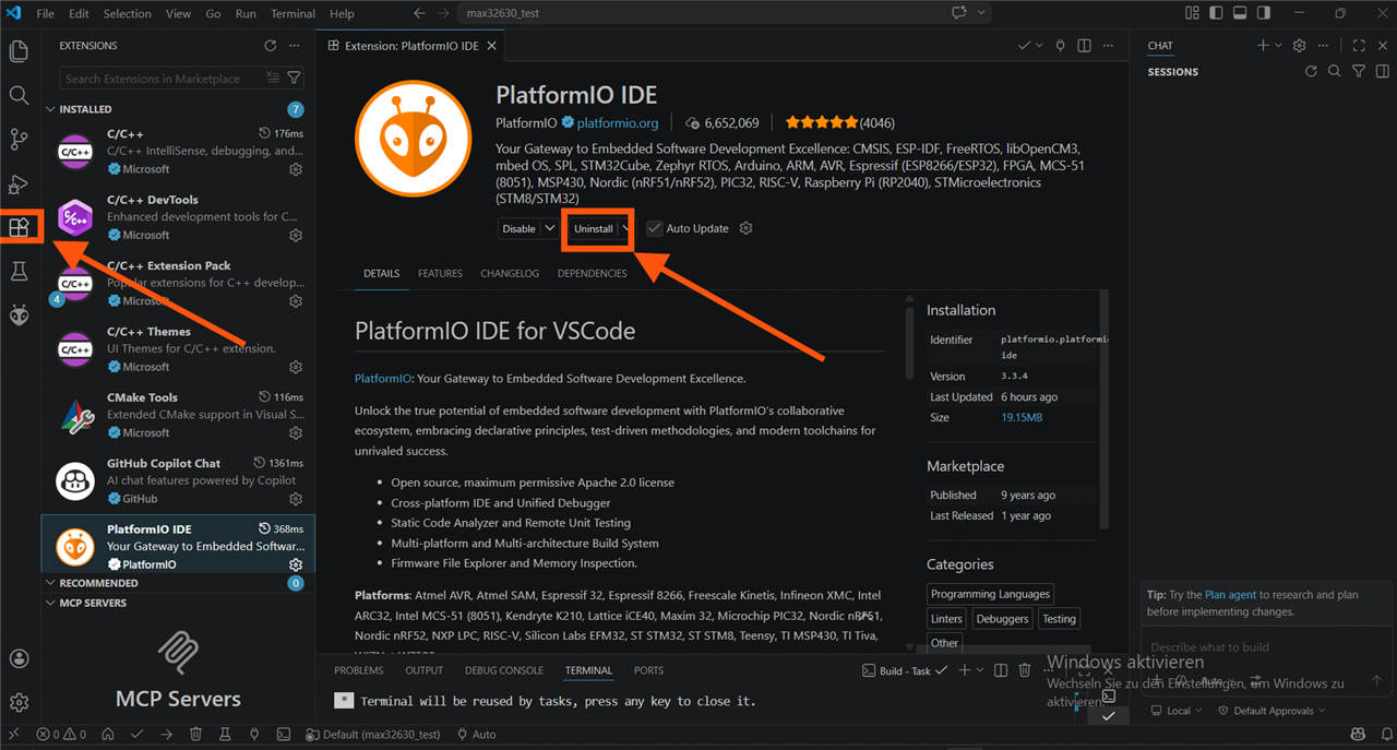

Step 2: Install PlatformIO
  • Go to Extensions in VS Code
  • Search for PlatformIO IDE
  • Install it
 What is PlatformIO?
PlatformIO is an extension that makes it easy to develop, build, and upload code to embedded boards. It manages libraries, toolchains, and programming automatically.
You can see that I have already installed it.
Warning️ After installation, restart VS Code.

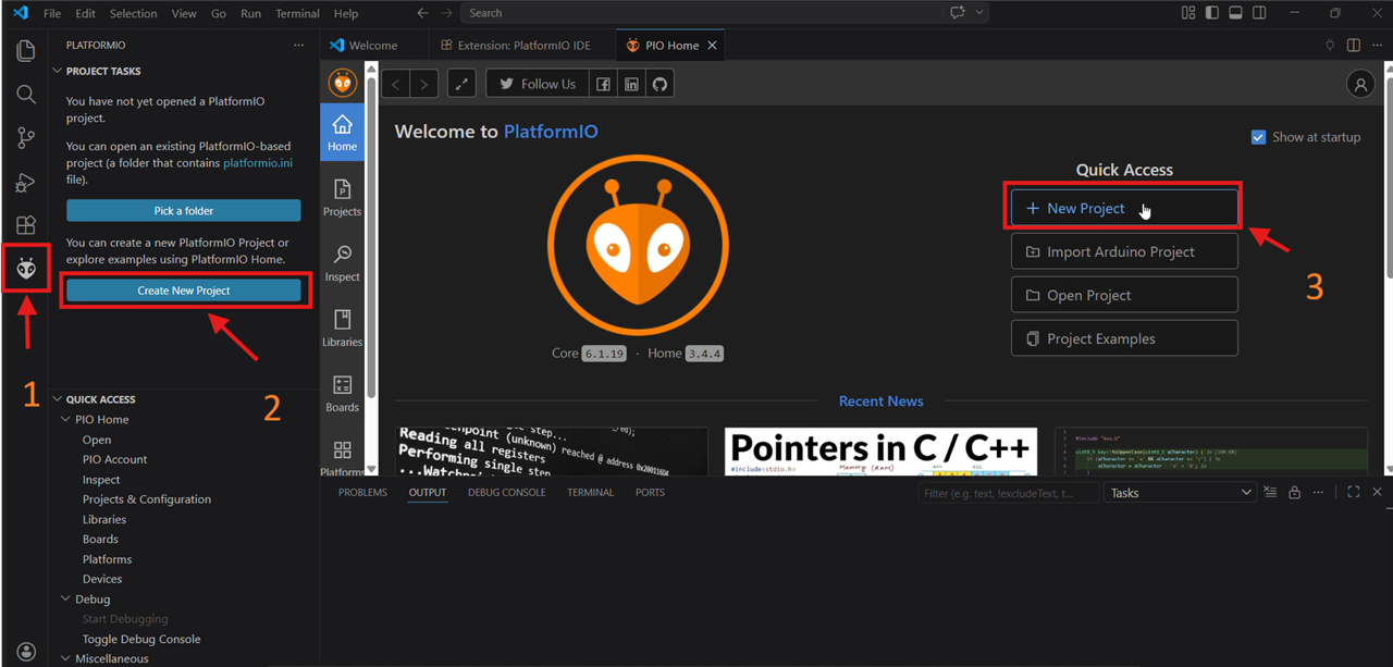

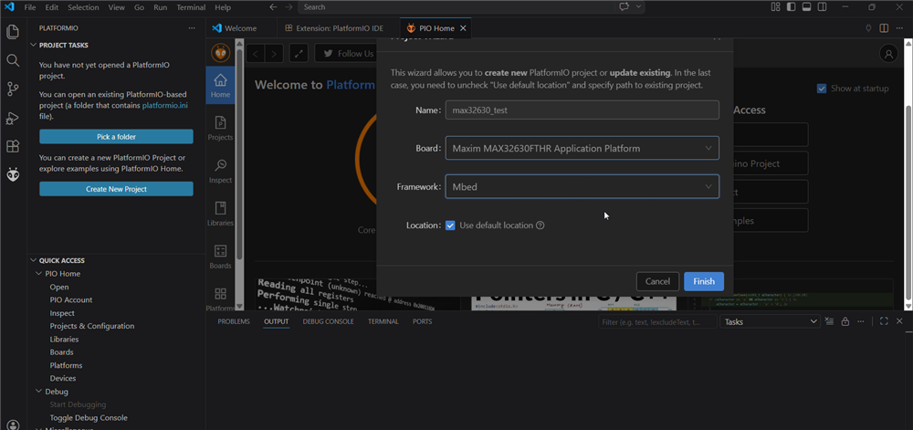

Step 3: Create New Project
  • Click on the alien icon Alien (PlatformIO) on the left
  • Click New Project
Fill details:
  • Project Name: max32630_test
  • Board: Maxim MAX32630FTHR Application Platform
  • Framework: Mbed
Click Finish and wait for setup.

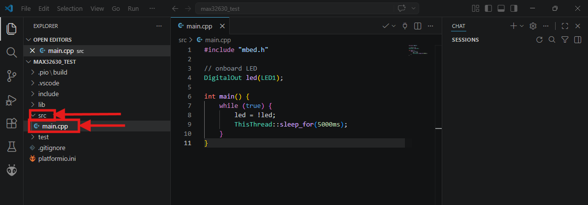

Step 4: Create Main Code File
  • Open src folder
  • Create new file → main.cpp
Paste this test code:
#include "mbed.h"
// onboard LED
DigitalOut led(LED1);
int main() {
while (true) {
led = !led;
ThisThread::sleep_for(500ms);

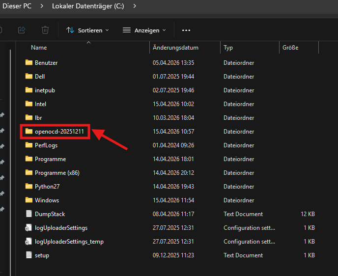

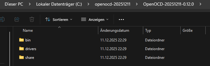

 Step 5: Download OpenOCD
  • Download from:
     https://gnutoolchains.com/arm-eabi/openocd/
  • Download the latest .7z file
  • Extract it to C:\
Make sure folder contains:
  • bin
  • drivers
  • share

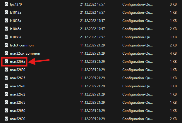

Step 6: Find Target Config
Go to:
share → openocd → scripts → target
Find file:
  • max32630.cfg OR
  • max3263x.cfg
 Remember this name

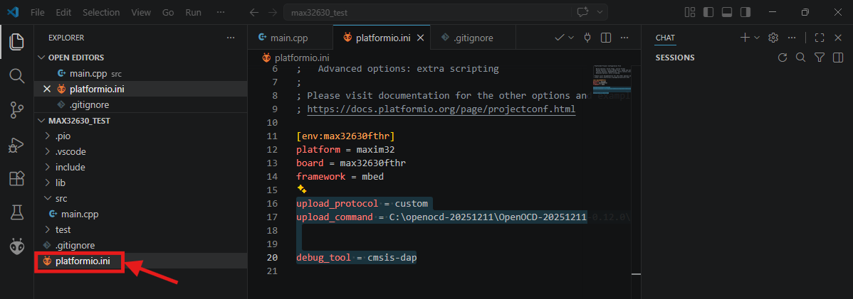

 Step 7: Update platformio.ini
Add these lines:
upload_protocol = custom
upload_command = C:\openocd-20251211\OpenOCD-20251211-0.12.0\bin\openocd.exe -s C:\openocd-20251211\OpenOCD-20251211-0.12.0\share\openocd\scripts -f interface/cmsis-dap.cfg -f target/max3263x.cfg -c "program .pio/build/max32630fthr/firmware.elf verify reset exit"
debug_tool = cmsis-dap
 Save the file

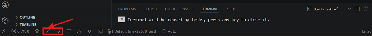

Step 8: Build & Upload
  • Click Heavy check mark (Build) at bottom
  • Wait for “Build Success”
  • Then click → (Upload)
Warning️ Important:
  • Always Save → Build → Upload
  • Do NOT upload directly
Upload Indicator (Important Observation)
During the upload process:
 The MAX32625PICO board starts blinking a green LED
This indicates:
  • Code is being transferred
  • Communication between PC and main board is active
This is a useful visual confirmation that the upload process is working correctly.
