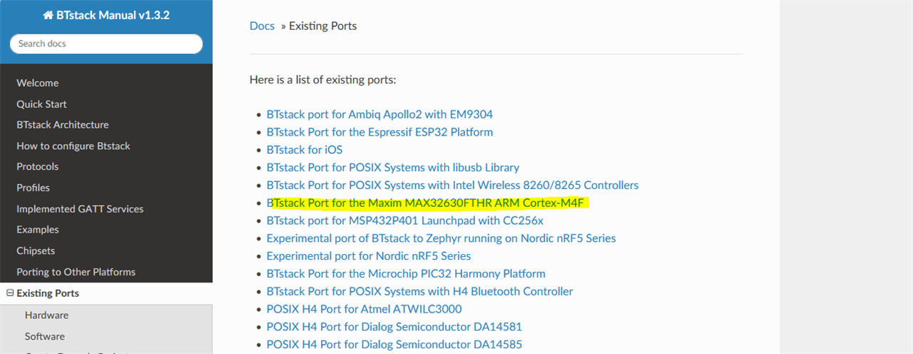

The Bluetooth Hardware
PAN1326B module a compact module from Panasonic built around the TI CC2564B chip. This gives you Bluetooth Classic + BLE 4.1. The CC2564B talks to the MAX32630 over UART. It is not a standalone BLE SoC unlike nrf52 and it is a radio that needs a host controller library on the MCU side to drive it.
A basic google search took me to BTStack - https://github.com/bluekitchen/btstack and their supported boards here: https://bluekitchen-gmbh.com/btstack/ports/existing_ports.html listed our MAX32630FTHR. I was happy.
Imported their git repo as a submodule to mine and
git submodule add github.com/.../btstack.git third_party/btstack
funnily enough i had to run the `make` command inside the btstack\port\max32630-fthr folder to generate the examples. The nice part is they also have shipped a copy of the LPSDK source files with BTStack, It brings its own board support file (board.c) written specifically for the FTHR, with UART1 on MAP_A (P2_0/P2_1) as the debug console and UART0 on MAP_B as the CC2564B interface. so nice of them.  No toolchain though. That's alright. Its the best way. They even gave a template for the makefile to make a fresh project with BTStack, It was a bit complicated to i asked chatGPT to help me mix my makefile and BTStack to make a makefile which will use the toolchain i already have with the LPSDK and BT Stack they have, which turned out to be like -

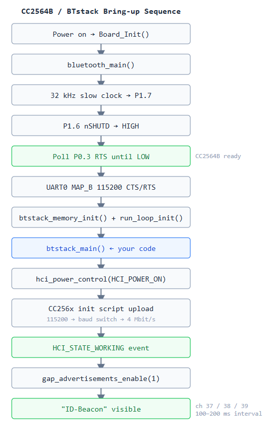

The Bring-up Sequence
Before getting to application code, it helps to understand what bluetooth_main() in the BTstack port does before it ever calls your  btstack_main
  1. Clock on P1.7 `init_slow_clock()` routes the internal 32 kHz RTC output to P1.7. The PAN1326B needs this as its reference clock.
  2. nSHUTD on P1.6-  the port drives this line high to release the CC2564B from reset. The UART line is not valid until nSHUTD is high and the module has had time to stabilise.
  3. RTS poll on P0.3-  after releasing nSHUTD, the code spins polling the CC2564B's RTS output waiting for it to go low. Only then is the HCI UART initialised.
  4. Baud rate renegotiation - the init script starts at 115200 baud, then a vendor-specific HCI command bumps it to 4 Mbit/s. BTstack handles all of this inside `btstack_chipset_cc256x`.
The BTstack MAX32630FTHR port provides its own `main.c` which takes care of all the run loop initialization as well as the transport initialization of the HCI interface. The application code is provided to `btstack_main()`, which is invoked by the port after it initializes itself. Therefore, there is no need to invoke `btstack_run_loop_init()` or `hci_init()`: In other words, there is no main loop in the main.c file. Read more about the Btstacks code architecture here: bluekitchen-gmbh.com/.../examples.html

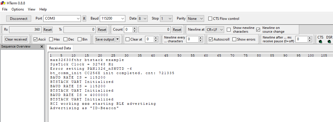

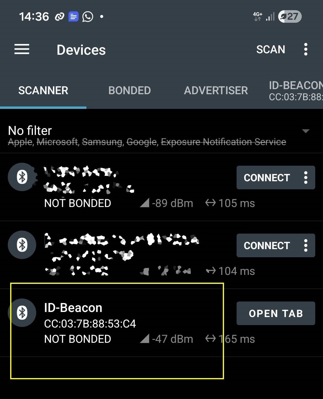

The code ran fine and i was able to verify it's working using the Nordic's Connect App on my phone.
Serial UART log via hterm
