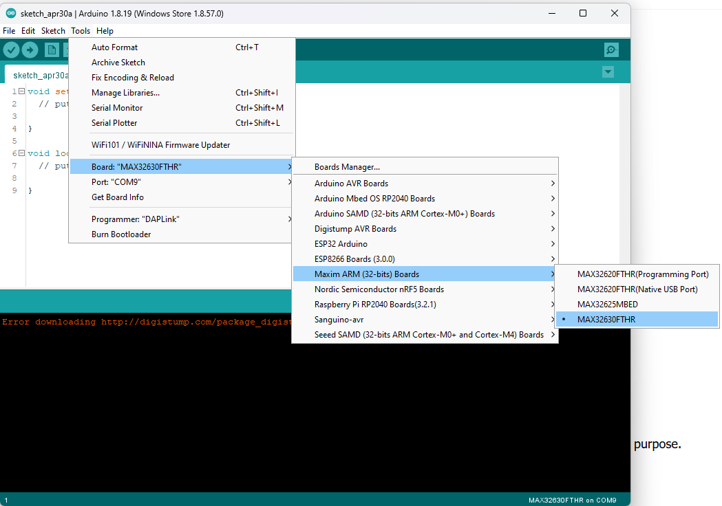

From my initial research i found that the MAX32630FTHR can be programmed using MBED OS, but unfortunately it will become obsolete or end of life this coming July. Hence while looking for other alternative, i saw the post from Alistair , mentioning about using Arduino to program the MAX32630FTHR. Here is my initial setup and the step to program the MAX32630FTHR using Arduino IDE. Below is the step to program the MAX32630FTHR with Arduino IDE. Please note that, it can be only used with Arduino IDE 1.8.x. I tried using Arduino 2.3.8, but it does not work.
Once the board is installed. I tried to program the board. The setup for programming the board is as shown in figure below
Programming the MAX32630FTHR setup.
Both the usb need to be connected. The usb on the MAX32630FTHR is for power up the device. And the usb connecting the pico is for programming purpose.
Once the this is done. I try to upload a simple Blink example, to verify. First choose the board as shown in the image below

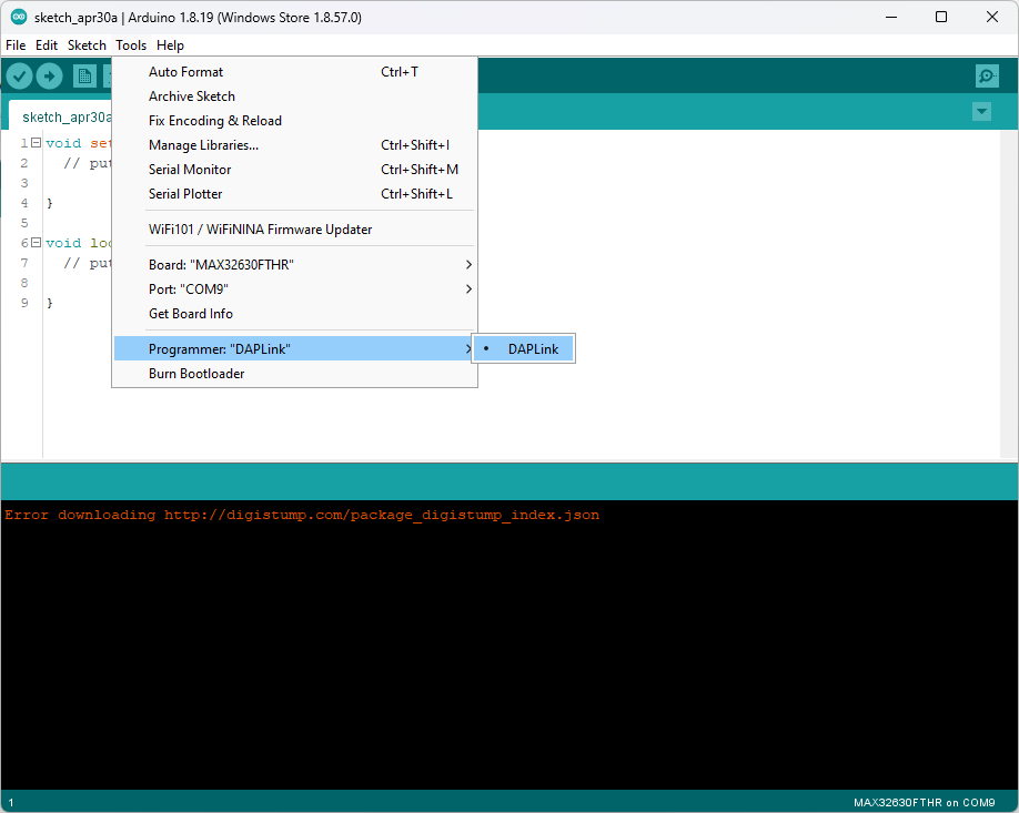

Next choose the programmer as shown in image below
Once done, i tested the simple blink program and it works. Below is the demo video
