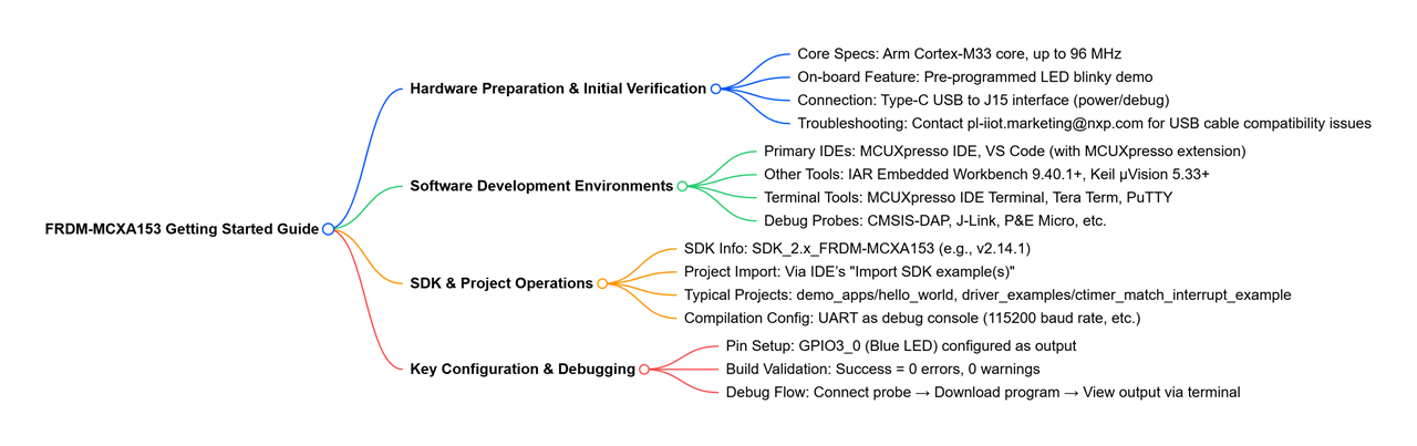

1.  Summary
MCUxpresso IDE  shall be normally used for FRDM-MCXA153 development board.
Software development environment setup, and example project execution start with validating hardware functionality by connecting a Type-C USB cable to the J15 interface; then  importing the SDK_2.x_FRDM-MCXA153, configuring UART (with parameters like 115200 baud rate) to  get started with this Arm Cortex-M33 coreboard. Here is how getting start up shall go.

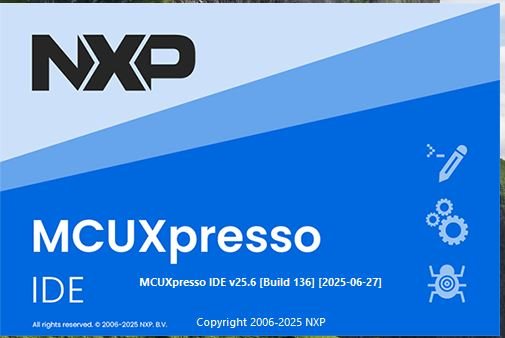

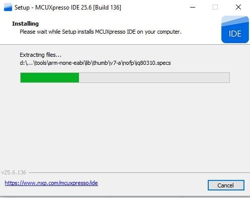

Install Mcuxpresso IDE and SDKs

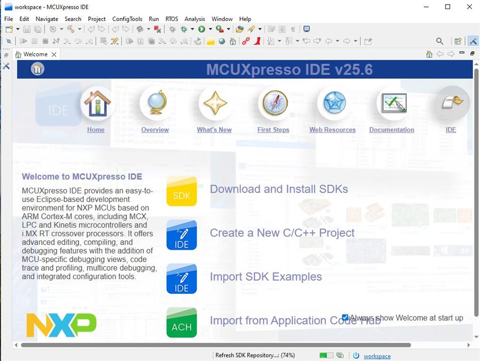

After start up, the new version change with new UI
Then goes to deshboard page
Other type of IDE is available as well
Tool Type Recommended Version/Configuration Core Purpose Key Settings
Primary IDE MCUXpresso IDE 11.8.0+ End-to-end project creation, compilation, debugging Supports SDK import and CMSIS-DAP probe connection
Cross-Platform IDE VS Code + MCUXpresso Extension Development on Windows/macOS/Linux Requires importing local SDK archive (e.g., SDK_2_14_0_FRDM-MCXA153.zip)
Other IDEs IAR Embedded Workbench 9.40.1+ Development for Cortex-M33 core Set debugger to CMSIS-DAP; target device = NXP MCXN947_core0
Other IDEs Keil µVision 5.33+ Requires CMSIS device pack (MCXNXXX_DFP) Select J-LINK in debug options

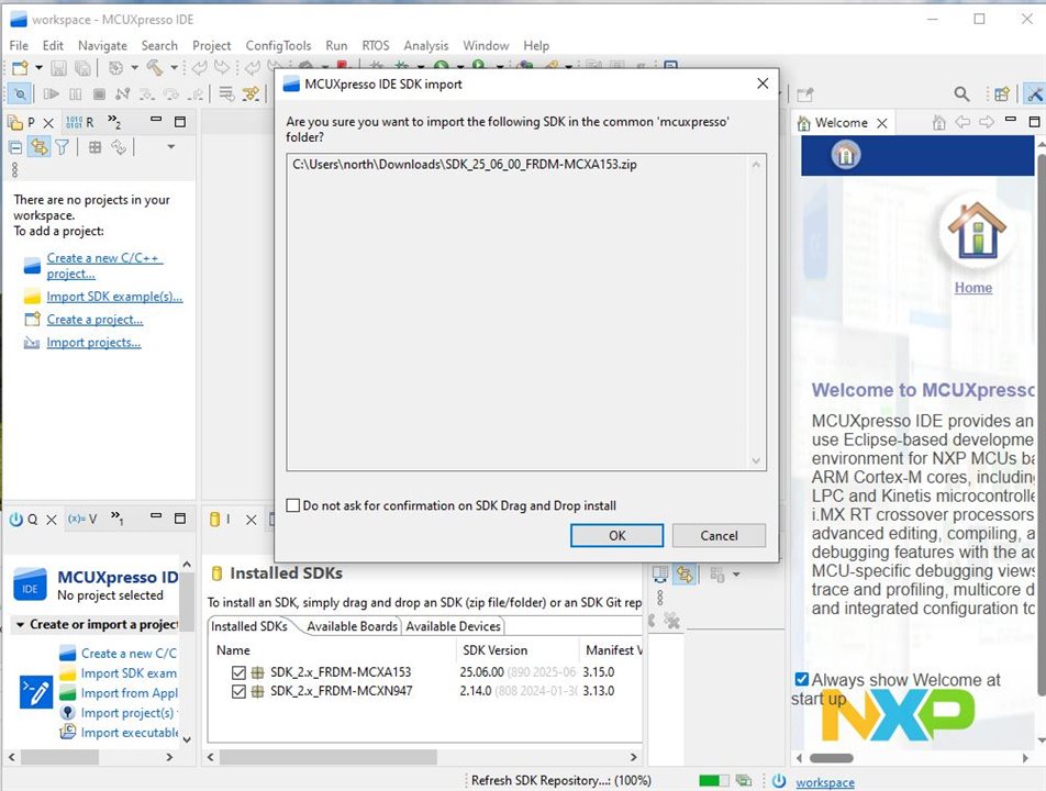

  1. SDK Acquisition & Import
    • SDK Version: Recommended SDK_2.x_FRDM-MCXA153  which must be unzipped in advance.
    • Import Path: In the IDE’s "Quickstart Panel", click Import SDK example(s) and select the FRDM-MCXA153 board and corresponding SDK.
Drap and install the sdk automatically

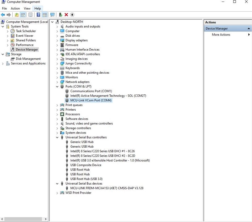

Plug in the board, the CMSIS-DAP driver is installed automatically and virtual port is added.
