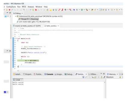

 I tried the “hello world example” on both devices to get a feel for developing on two devices from the same IDE on the same PC. I followed the instructions from the “Build and Run Page” outlined above. I was able to get the example to run on the MCXA153 the first time, but unable to successfully run again after getting the following problem, trying to run it on the MCXN236

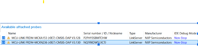

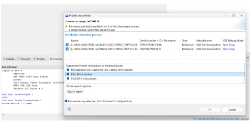

  3. The following dialog appears to select a probe
    1. I selected the MCU-Link CMSIS-DAP debug probe for the MCXN236:
Hint: the next time you run the code, this screen does not show. to allow it to show up again , simply delete the file "frdmmcxn236_hello_world LinkServer Debug.launch", in this case for the MCXN236. Now the dialog should come up on the debug session.

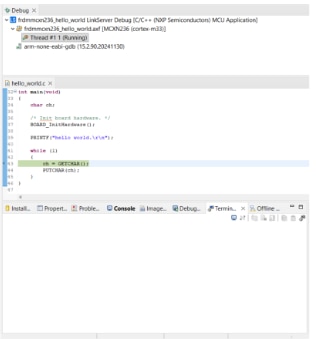

Open up a serial terminal to be able to see the application's output.
       Problem: empty terminal?
What could be wrong?
Solution : I had the wrong Serial COM port selected. It needs to be the com port that the MCXN236 is connected to . In my case it is COM4.

Now the debugger is running but it hangs the code here after pressing a character on the screen?
NOW I’m stuck and pondering this second Problem:
Why is it printing 2 lines of “Hello World”?
Why is it paused at the line ch = GETCHAR();
What is it expecting from the function call GETCHAR()

    I'm also facing the same issue when using two boards at the same time.
    1. The reason you are getting two "Hello world" is, after the firmware was flashed, it immediately starts running in application mode before switching to debug mode.
    2. GETCHAR() is a blocking UART receive function that requires you to type a character in the serial terminal.
    3. Once you provide an input, it'll be printed automatically on the screen using PUTCHAR(ch);

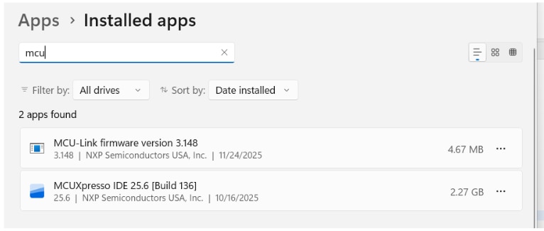

    Jan Cumps 11 months ago in reply to skruglewicz
    The strange thing is that you have an older version of both the IDE and debug software installed after a newer version.
  • skruglewicz
    skruglewicz 11 months ago in reply to Jan Cumps
    The problem manifested itself before I installed the IDE v24? that I installed in the hopes to fix my problem
