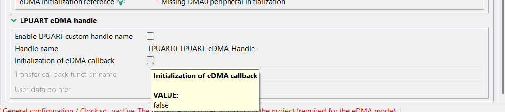

  8. Switch to “Component” view. From here we can select the driver for our required peripheral, if we have selected CMSIS from the welcome page, we can see it listed here as well. Select the required one and click generate code.
    1. Component page offers a variety of ways to configure a peripheral when device specific component is selected and the SDK components can be modified anytime.
      1. Polling – Standard blocking way of sending/receiving data
      2. Interrupt – Standard interrupts set by using interrupt flags.
      3. Transfer – Provides blocking as well as non blocking API with support for interrupts
      4. DMA – for transferring huge amount of data faster, supports interrupts.

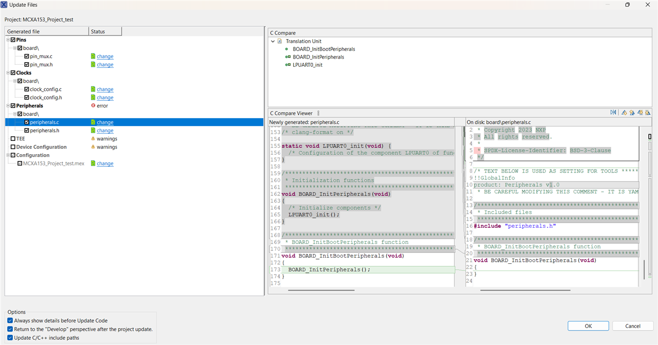

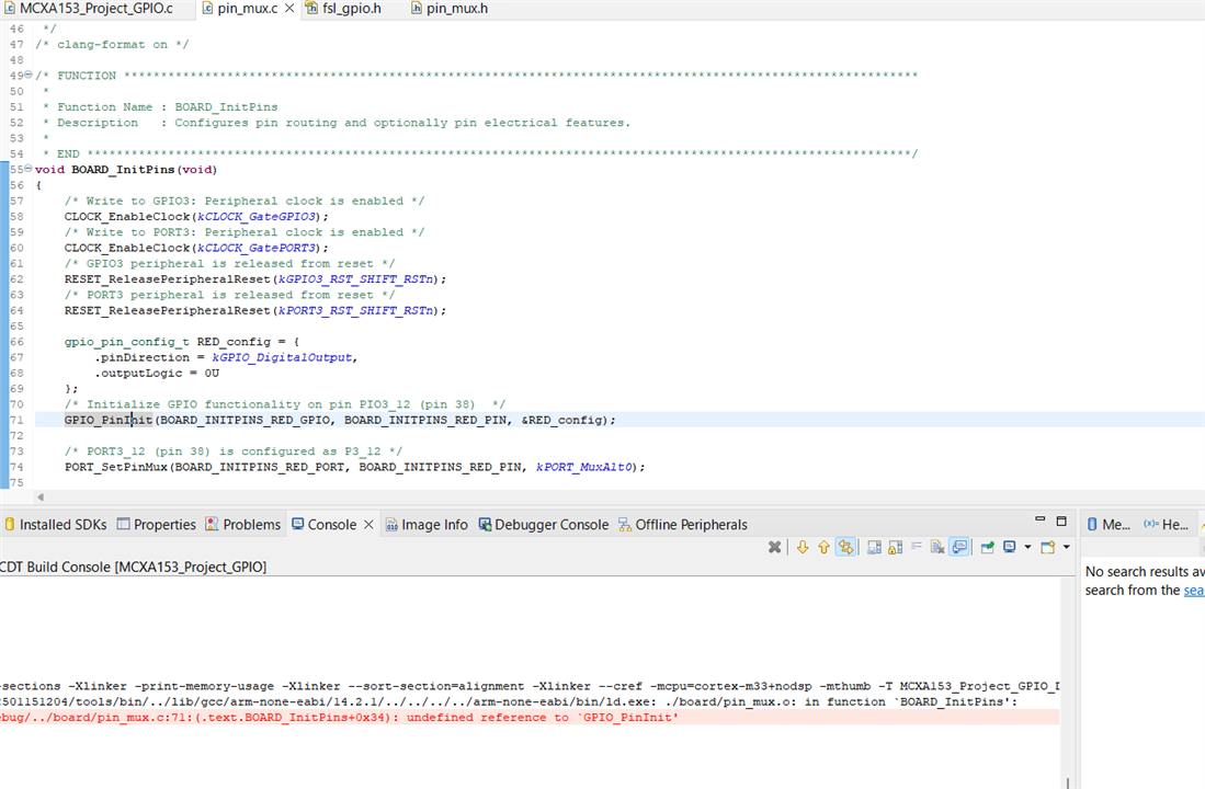

    I also watched your video tutorial on using GPIOs, and followed along with your steps. However, when I tried to build the project, I unfortunately received a build error (screenshot below).
    I might add that I am using MCUXpresso SDK version 25.09.00, whereas your example used version 25.06.00.

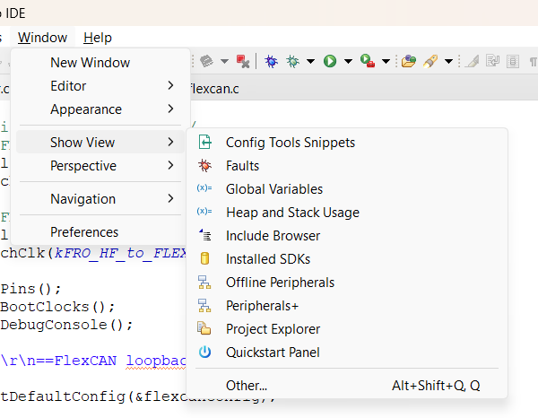

    Also I was unable to figure out how to get to the component view, so I was unable to perform that step.

  • balajivan1995
    balajivan1995 11 months ago in reply to skruglewicz

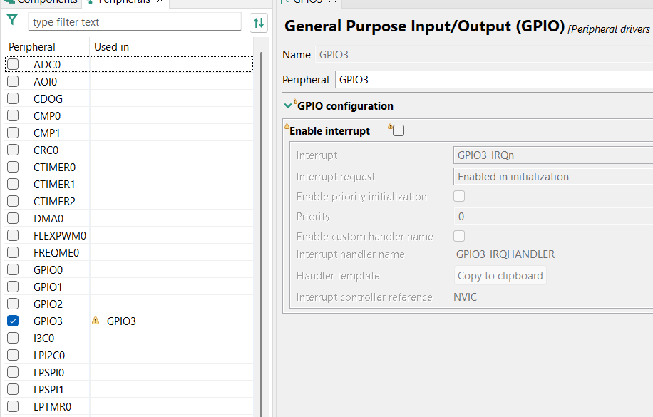

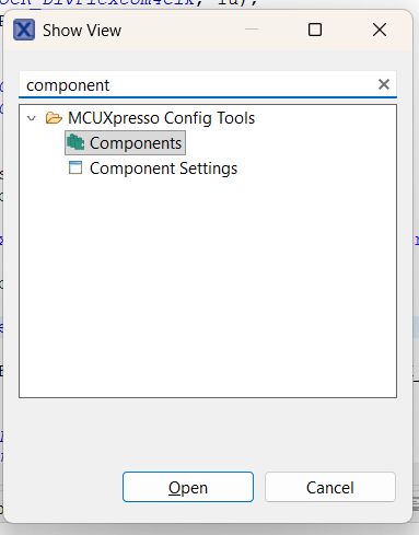

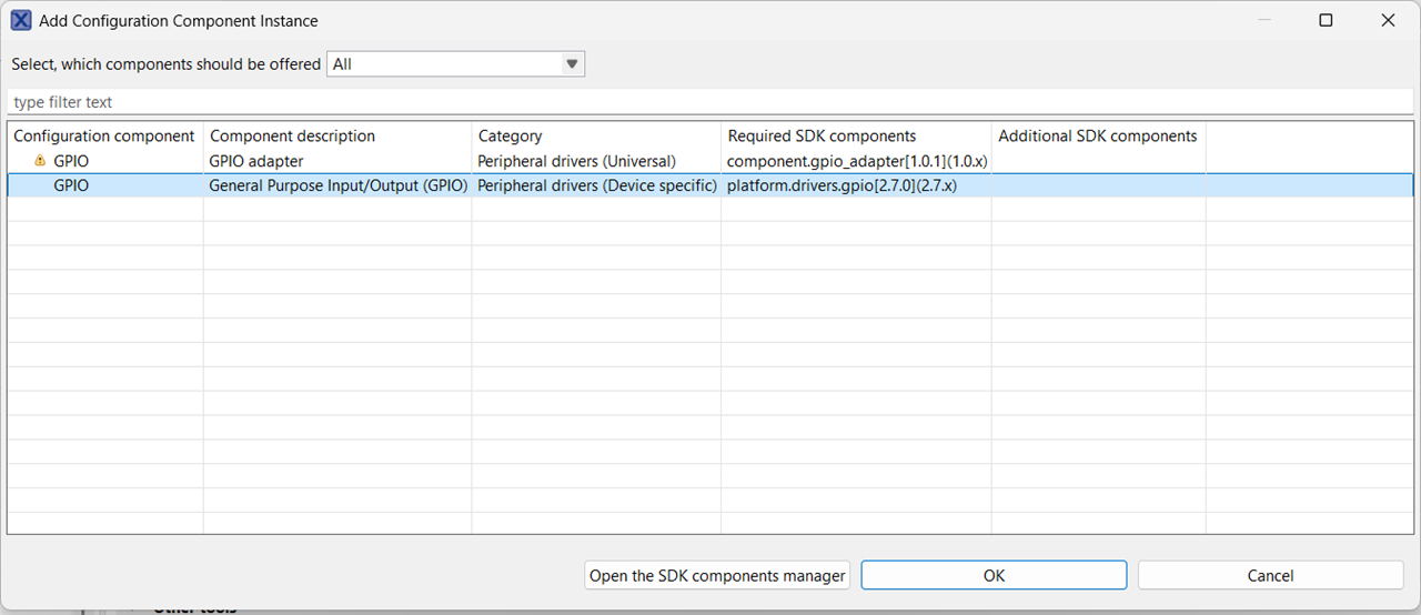

    To reach components view,
    Click "Windows" on tool bar, select "Show view", click "other" and type components in the search field
  • skruglewicz
    skruglewicz 11 months ago in reply to balajivan1995

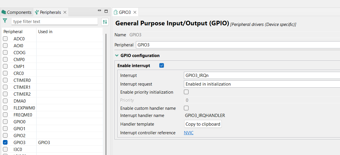

    Thanks for the reply I was able to find the components/peripherals panel .
    I was able to find the peripherals panel and enable the interrupt for GPIO3
    I still have the Build error mentioned in my initial reply.

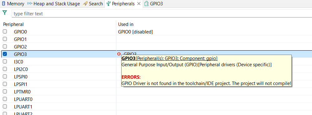

    When I set the interrupt for GPIO3 and generate the code I noticed an error message On the Peripheral panel I'm not sure if I received before but it could be the with the build.
    I can't understand the GPIO Driver is not found?
    Does this make any sense to you?
    Thanks in Advance

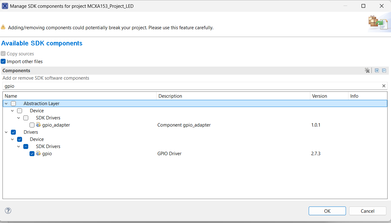

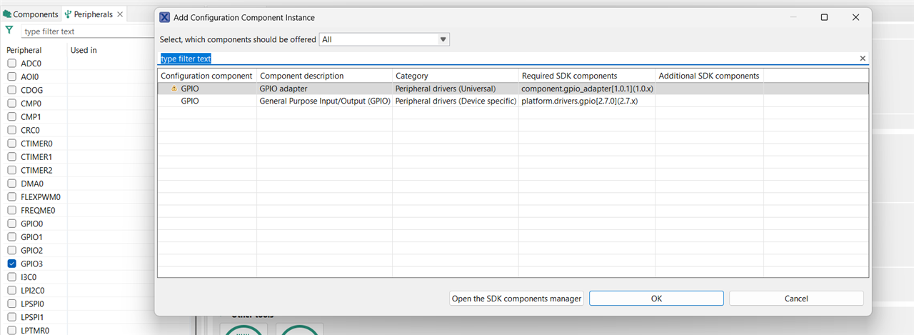

  • balajivan1995
    Remove the existing component on GPIO3 by right clicking and remove it. (Remove the GPIO3 on right side)
    Now, uncheck and check the GPIO3 on left side. A pop will immediately open and ask you to select the SDK component
    Since I have enabled the device specific GPIO driver, the first one (universal driver) is showing warning and second one (device specific driver) is not showing error.
    In your case, if both are showing warning, select "Open the SDK components manager" option at the bottom. Search for GPIO to narrow down the driver.
    I would suggest using the last one. Click OK. Device specific driver will be warning free. Select that one and click Ok.

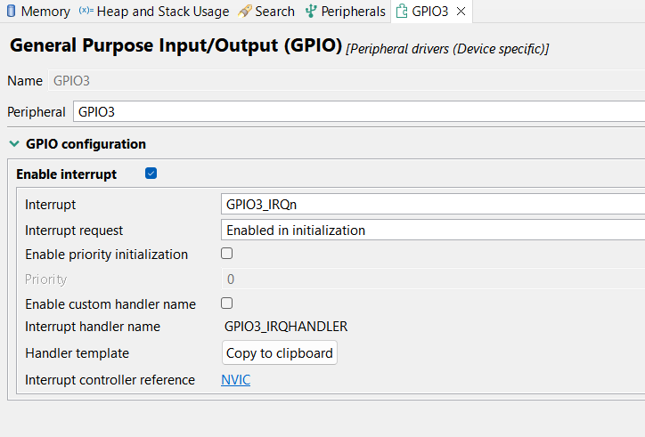

    Now, there will be a warning icon on GPIO driver because it expects interrupt to be enabled.
    Check "Enable interrupt" and the warning will go away
    Then click update code and build your project.
    Hopefully, GPIO related error will be resolved.
