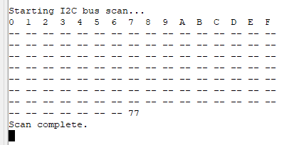

It has been quite a journey and I am making progress at snail's pace. While the SDK is shipped with a lot of examples, it is somewhat difficult to find requisite information.
I wanted to perform a scan of the I2C bus to detect devices. I got it working but I was not able to get the driver working.
The I2C bus scanner didn't work either. It turns out that the I2C devices needed a reset.
Onward to integrating the driver again.

    I confess my approach is more work. I have a Raspberry Pi setup to support I2C. I used that as my tool of choice to confirm I2C devices on a network. I find since I'm more familiar with that tool, I have some confidence I'm doing things right. When I can see it with that, I switch to the other tools for fine tuning.

    I see there is one device with address 0x77. Is it the device you search for?
    What device you run scan on? What device you scan for?

    Yes. This is the device I was looking for. It has been a pain.
