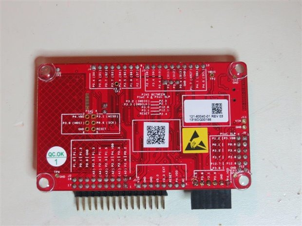

BTW - The photo above has nothing to do with the timer component except to show the backside of the Pioneer Kit and its very useful annotations.
