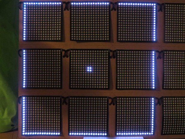

Another boring photo but it shows 9 panels (2,304 LEDS) being driven by a single PSoC 4 and my one of my secret circuits.
Anyone for TV tennis as a side project?
I could have used colour but decided of a low brightness white.
Each panel has a unique pattern displayed to prove that it that is individually driven.
The only reason for 9 and not 12 panels is that I only have a 3A power supply attached.
With no LEDs lit the quiescent current is 2.13A. It sounds a lot but it works out to be about 1mA per LED.
One remarkable aspect of the WS2812B LEDs is that they are static so once a value has been assigned to a LED it will remain in that state indefinitely until the value is changed, the power removed or the device is broken.
Yes, sure enough each LED has 3 bytes of RAM.
The caveat is that it is only optically readable.
Technology, what'll they think of next?

    It looks like you have the setup to do some awesome displays with that level of control.
    I like the idea that the LED will hold its last state until it receives an update.
    May have to look into those LEDs for one of my projects.
