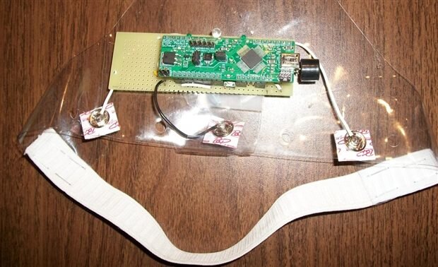

All components are surface-mounted. The connectors are mounted so that they match the corresponding port connectors on the Schmartboard. That way, the prototype board plugs directly into the Schmartboard like this:
So after building this system I mounted it on a headband and connected the electrodes like this:
Then I placed it on my forehead and tested it , but… to my surprise it did not work image

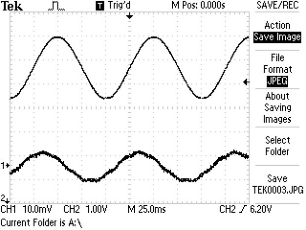

To answer this, I started to probe the electric signals along the amplifier path. For a stimulus, I used a sinusoidal waveform generator with a resistor divider attenuator and capacitive coupling into the electrode inputs. For this setting I first measured the attenuation factor as seen in this plot:
The generator output (ch2) had about 2.6V pk-pk signal and the attenuated signal had about 10mV pk-pk. So my resistor divider had an attenuation factor of about 3.85*10^(-3). This means that if I want to apply a signal similar to the electric levels of bio-signals generated by eye movement, which are in the order of 20-50uV, I need to set the generator amplitude to about 10mV (which has a value that I can measure with the oscilloscope). So I applied 10mV and I probed with the oscilloscope the output of opamp 3 in the schematic below, but the only thing I saw was noise; I couldn’t distinguish any sinusoidal signal. Then I measured the noise at the opamp 3 output without any signal applied at the input, and I saw significant high level of noise as I am showing in this plot:
