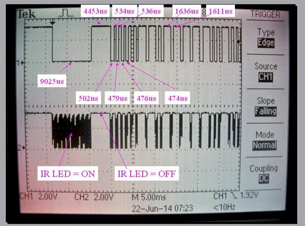

In the previous two blog posts I described how I got to the point where my algorithm captured the infrared signal and measured the duration of demodulated carrier-on and carrier-off pulses. In this blog I am showing how I compress the measured signal into a format that I can store in the EEPROM memory inside the PSoC5LP.  The following figure shows a demodulated infrared signal (upper trace) and raw received signal that includes the carrier frequency (lower trace).  On the figure I marked the pulse width measured with the PSoC5LP algorithm that I developed so far.

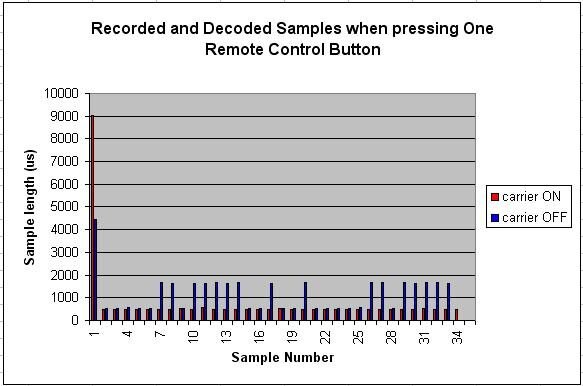

So my next step was to take a look at the data and see what I can simplify.   I started by plotting the pulse lengths on a graph, shown in the figure below:
The bars shown in red represent the time while the infrared carrier signal is on and the bars shown in blue represent the time while the carrier signal is off.  These values correspond to the waveforms shown in the first figure above.  This graph suggests that the information is encoded in two types of pulse lengths of carrier-off, a short pulse and a long pulse.  The carrier-on pulses are all of similar length.  The two very long pulses right at the beginning are the preamble used by receivers to tune the local oscillator and demodulator. They do not transmit command specific information, but I still need to record their length since I need to reconstruct them when driving the transmitter infrared LED.

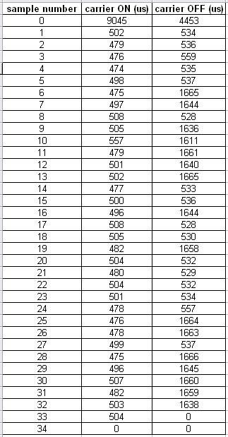

My approach to compress these arrays of data is to compute a unit interval of time based on all the recorded pulse lengths, and then to express each pulse length in terms of this unit interval.  Looking at the graph above I see that all the short pulses have similar values but are not equal, and all the long pulses have similar values but also are not equal.  It also looks to me that the long pulses are three times longer than the short pulses.  After doing some reading on the various encoding techniques used in infrared remote control protocols I realized that a good choice would be to always express the pulse lengths in an integer multiple of the shortest pulse.  However, due to measurement errors the duration of the short pulse is not easy to determine.  Here is the pulse table with values represented in the graph above:
The short pulses span values between 474us and 557us and the long pulses between 1611us and 1666us.  So visually a good choice for unit interval would be 515us, the average short pulse length.  The challenge was then to implement this “visual” choice into an algorithm executed by the MCU inside the PSoC5LP chip.

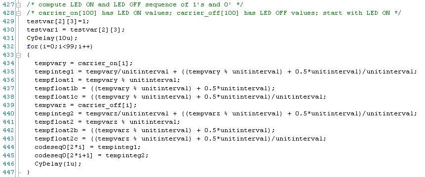

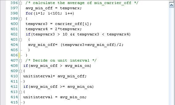

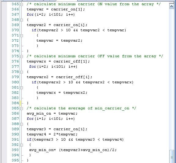

Here is the code that I wrote to determine the unit interval:
The code first calculates the minimum and average pulse width of carrier-on and carrier-off values from the arrays and then computes the unit interval.  Then each pulse length is converted from microseconds into unit intervals and stored in another array.  The resulted pulse lengths have now values of either 1 or 3, so the amount of data is significantly reduced.  If I further convert these values into logic “1” and logic “0” bits I can fit them in one row of the EEPROM nonvolatile memory in a PsoC5LP chip.
