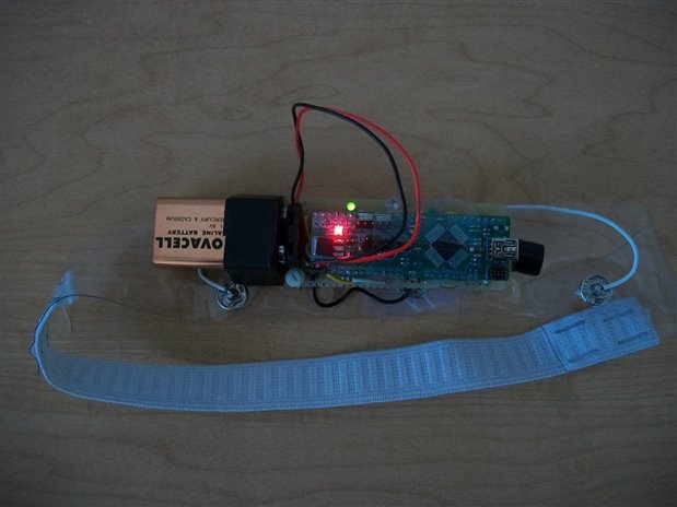

The physical implementation used the PSoC5LP of the Schmartboard evaluation board that I described in my previous blog post.  The additional components shown in the schematic above are mounted on a soldered breadboard and connected to the Schmartboard  I/O connector.  The entire system is then mounted on a headband as shown in the picture below.
To power it up I used a 9V battery, but for the final design I am planning to use a 3V supply from a small battery CR2032 the type that is used on computers motherboards.  I will transition to that battery type after I finalize the algorithm in PSoC5LP and I implement all possible power savings techniques.

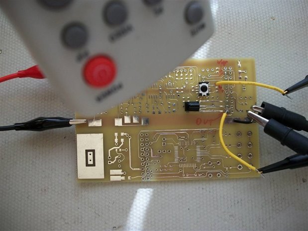

This  is not an easy task; after starting to get familiar with infrared remotes and transmission codes I found out that there are multiple protocols of data encoding and even worse, multiple carrier frequencies.  The most common carrier frequencies are between 33kHz and 60kHz:  30kHz, 33kHz, 36kHz, 38kHz, 40kHz, and 56kHz.  Infrared receiver chips are of two types: the most common type receives and decodes the signal, however, one receiver chip is “tuned” for only one carrier frequency.  If I want to use this type of receiver I then need to have one receiver for each possible carrier frequency, which will increase significantly the cost and size.  The second type of infrared receiver is a “raw” signal receiver that outputs a digital signal representing the pulse-modulated carrier frequency.  To further clarify how they work I built a simple experiment using both types of receivers: a TSMP6000  that shows the raw signal and allows measurement of carrier frequency (response 20kHz to 60kHz) and a TSOP38238  that is tuned on a single carrier frequency and outputs the demodulated signal. I have mounted these two receivers on a prototype board as shown in the figure below:

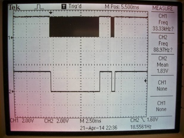

I then powered up the board from a 3V supply, I pressed the buttons on a remote control, and I measured the waveforms with an oscilloscope.  The figure below shows two signals: the lower waveform represents the output of TSOP38238, which is the demodulated signal, and the upper waveform represents the output of TSMP6000, which is the same signal but with the carrier frequency.
