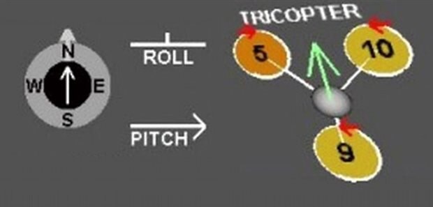

Slight difficulty with ESC was the next: after soldering it turned out that one of the motors rotated in the wrong direction, good still, that ESCs of "HobbyKing BlueSeries" support software change for direction of rotation. Now motors rotate like this:
