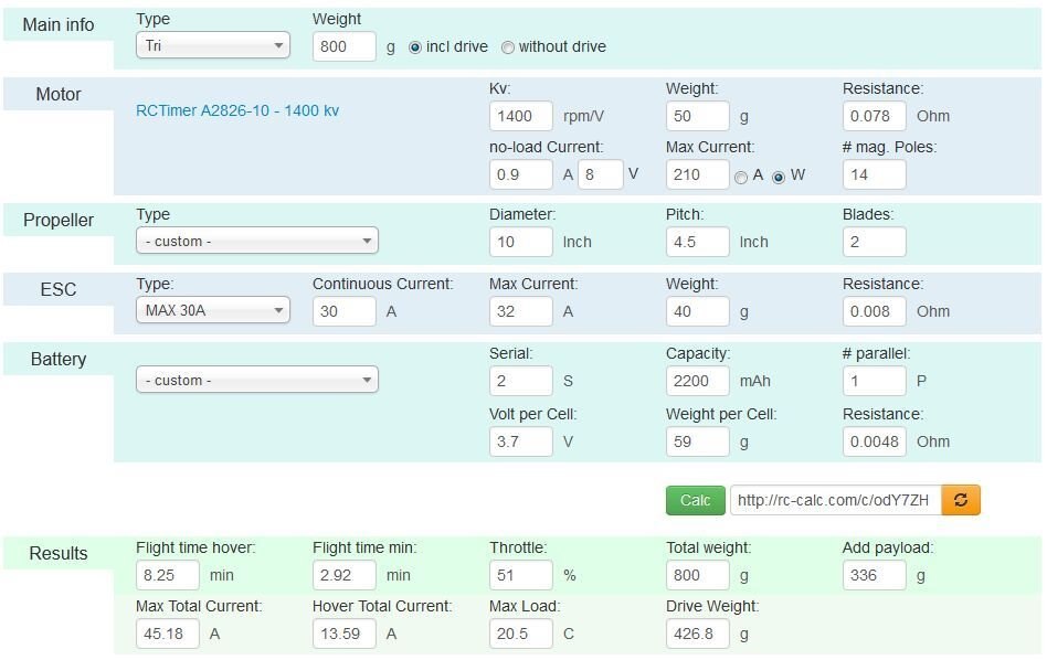

According to calculations, the device should hang at throttle = 50%:
When conducting flight  the throttle lays in the range of 30-50% because I was afraid to raise apparatus higher than 2 meters. In case of a skilled pilot (which I am not) and good weather conditions, the device can easily go up, performing tricks at a great speed!

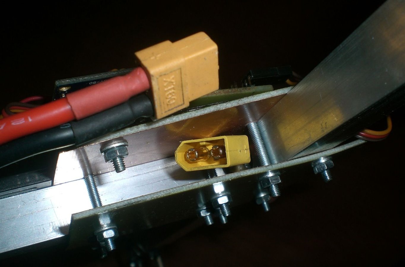

  • The power connector is in a wrong position, it is very inconvenient to disconnect it from LiPo, for this we have to make great efforts. Though it is a small thing, but apparently it was the reason of breakage of a wire last week!
