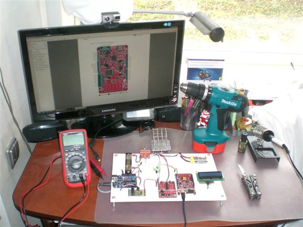

Today I want to talk about my first and second applications for the PSoC 4. But we'll start with my new testing station.
On my small, but cosy workplace you can find:
  1. 23" PC monitor
  2. Multimeter (UNI-T UT61C)
  3. Drilling tool (Makita 8391)
  4. Soldering iron (NoName)
  5. Multitool (Gerber Suspension)
  6. Universal testing station
  7. Piece of russian nature outside the window image

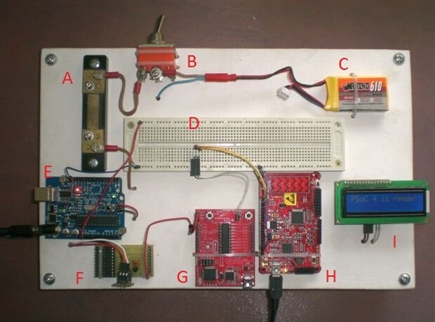

Let's learn more about by testing station:
I used this station for demonstration of my graduation project a few years ago, now I just modified it to work with PSoC and Arduino.
It consists of:
  • A. Current shunt
  • B. Power switch
  • C. 2S LiPo (aka autonomous power supply)
  • D. Breaboard
  • E. Arduino Duemilanove (with ATmega328p)
  • F. Part of my old MSP430 RF project
  • G. MSP430 LaunchPad (with MSP430G2553)
  • H. CY8CKIT-042 PSoC 4 Pioneer Kit
  • I. LCD with I2C interface

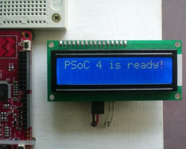

My first application was traditionally HelloWorld. You can see it on the previous photo. I just connected PSoC 4 to LCD via I2C and sent a phrase "PSoC 4 is ready!".
However after some time of work this LCD went to another world... I found out the problem but this week I have not enough time to repair it image

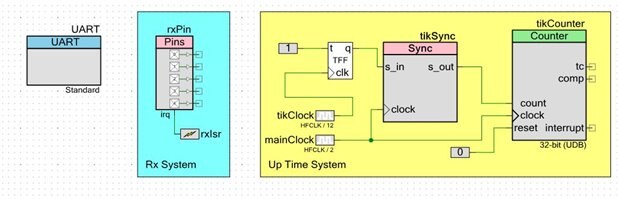

In this screenshot you can see the 'PSoC schematicos' of this application:
  • Yellow: In my application I need two arduino funcitons: delay(ms) and micros(). So I create this 'yelow block' to calculate uptime (operation time). It looks simple but in PSoC 4 I found an interesting situation: we can only communicate clock-block output to clock input of any other blocks! For example I can't connect clock-block derectly to pin. But I found a solution! I read this article and add a TFF block to my application.

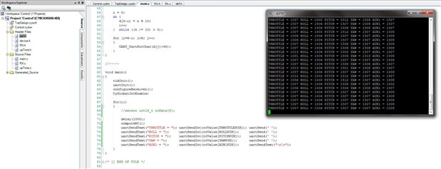

  • Blue: As you know I like MultiWii 2.0 so I just rewrote RX.ino file for a PSoC.
As a result I managed to read all the necessary signals with Rx/Tx system and transfer them via the UART on the computer:
On forthcoming week I plan to realize all necessary UART functions and probably to communicate PSoC with standard MultiWii PC application. See you next week!
