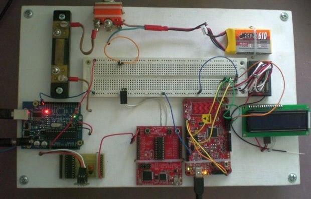

Let's learn more about by testing station:
I used this station for demonstration of my graduation project a few years ago, now I just modified it to work with PSoC and Arduino.
It consists of:
  • A. Current shunt
  • B. Power switch
  • C. 2S LiPo (aka autonomous power supply)
  • D. Breaboard
  • E. Arduino Duemilanove (with ATmega328p)
  • F. Part of my old MSP430 RF project
  • G. MSP430 LaunchPad (with MSP430G2553)
  • H. CY8CKIT-042 PSoC 4 Pioneer Kit
  • I. LCD with I2C interface
My first application was traditionally HelloWorld. You can see it on the previous photo. I just connected PSoC 4 to LCD via I2C and sent a phrase "PSoC 4 is ready!".
However after some time of work this LCD went to another world... I found out the problem but this week I have not enough time to repair it image
