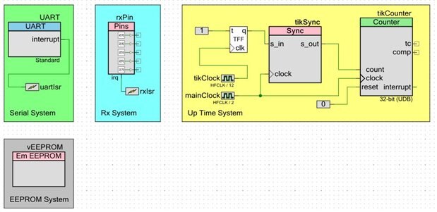

Let's talk today about the next stage on the road to success, namely about the EEPROM emulation.

So let's go! An important part of the software for a tri or quadcopters is the non-volatile memory for storage of configuration. In the AVR-based MultiWii we use EEPROM as the most suitab.PSoC has the ability to emulate EEPROM memory, for this purpose there is a special unit which is a nothing else but the API to access the flash memory of the controller, which, like the EEPROM is non-volatile.
Today PSoC's schematics look like this:
Like the last time, here is a piece of code that I use to work with virtual EEPROM:

So, let us examine the steps, how our software is working at the moment:
  1. The configuration of all the systems (UpTime, EEPROM, Serial, RX);
  2. After initialization of the EEPROM we test the "is it a first running of the system?" if Yes, the defaulte date is recorded in the EEPROM;
  3. After configuration we turn on the global interrupts;
  4. In the main loop we read the data from RX and trying to communicate PSoC with PC-program;
  5. If PC-program requests the data - we try to transmitt it via UART;
  6. If PC-program suggests to write the data to EEPROM, the PSoC tryint to get it and write it to EEPROM via writeParams() function

As you can see, the data was successfully wrote to EEPROM and read back again after voltage brownout!
