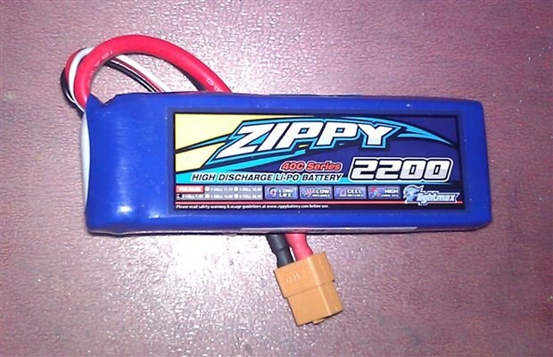

1. I finally got the first package from HobbyKing:
one 2200mAh 3S LiPo. Other details are taking long time to arrive, I hope to get them soon.

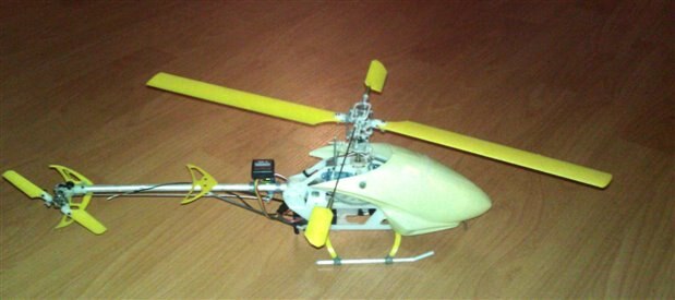

So, a bit of theory. As it is known I use BLDC's in my copter and they require specialized control system. I went the easy way out and decided to buy such a system from HobbyKing, however, there is a small problem: I have not BLDC motors and I have not ESC's (motor control systems) However, I worked previously with such systems when I built my helicopter:

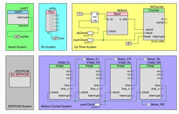

Let's consider 'PSoC Schematics' obtained at a given time :
As you can see I have not used UDB-blocks, because they ended image
Purple module:
  • PWM_FL - front left motor (for quad and tri);
  • PWM_FR - front right motor (for quad and tri);
  • PWM_RL - rear left (for quad) or rear (for tri) motor;
  • PWM_RR - rear right motor (for quad) or YAW servo (for tri).

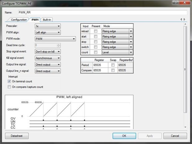

The configuration of each PWM unit was left by default:

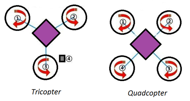

I don't want to show all of the code of the motors and servo control system, I'd better say in words how a copter works:
Quadcopter:
  • Right/Left (ROLL): increase/decrease motors 1 and 4 power, decrease/increase motors 2 and 3 power.
  • Forward/Backward (PITCH): increase/decrease motors 3 and 4 power, decrease/increase motors 1 and 2 power.
  • Turn clockwise/counterclockwise (YAW): increase/decrease motors 1 and 3 power, decrease/increase motors 2 and 4 power.
  • Up/Down (THORTLE): increase/decrease all motors power.
I think, it's very simple and clear.
Tricopter:
- Right/Left (ROLL): increase/decrease motor 1 power, decrease/increase motor 2.
- Forward/Backward (PITCH): increase/decrease motor 3 power, decrease/increase motors 1 and 2 power.
- Turn clockwise/counterclockwise (YAW): by servo.
- Up/Down (THORTLE): increase/decrease all motors power.
As you might have guessed, this week has implemented mixing of channels, and now, I can try to configurate my sistem on a real copter, but unfortunately I haven't got it yet...

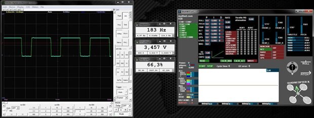

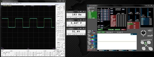

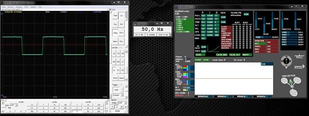

For example, I made a few screanshoots of MultiWii GUI and the testimony of the oscilloscope in one of the channels:
Thorttle = 0:
Throttle > 0:
I also measured the signal using oscilloscope from the YAW-output (servo), in the case of tricopter configuration:
