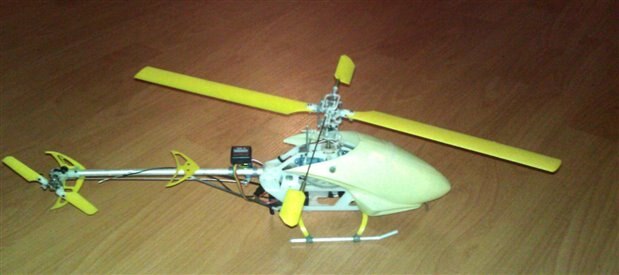

So, a bit of theory. As it is known I use BLDC's in my copter and they require specialized control system. I went the easy way out and decided to buy such a system from HobbyKing, however, there is a small problem: I have not BLDC motors and I have not ESC's (motor control systems) However, I worked previously with such systems when I built my helicopter:

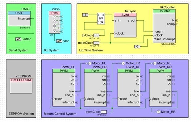

Let's consider 'PSoC Schematics' obtained at a given time :
As you can see I have not used UDB-blocks, because they ended image
Purple module:
  • PWM_FL - front left motor (for quad and tri);
  • PWM_FR - front right motor (for quad and tri);
  • PWM_RL - rear left (for quad) or rear (for tri) motor;
  • PWM_RR - rear right motor (for quad) or YAW servo (for tri).
The configuration of each PWM unit was left by default:
I don't want to show all of the code of the motors and servo control system, I'd better say in words how a copter works:

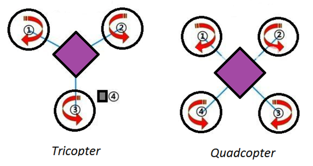

Quadcopter:
  • Right/Left (ROLL): increase/decrease motors 1 and 4 power, decrease/increase motors 2 and 3 power.
  • Forward/Backward (PITCH): increase/decrease motors 3 and 4 power, decrease/increase motors 1 and 2 power.
  • Turn clockwise/counterclockwise (YAW): increase/decrease motors 1 and 3 power, decrease/increase motors 2 and 4 power.
  • Up/Down (THORTLE): increase/decrease all motors power.
I think, it's very simple and clear.
Tricopter:
- Right/Left (ROLL): increase/decrease motor 1 power, decrease/increase motor 2.
- Forward/Backward (PITCH): increase/decrease motor 3 power, decrease/increase motors 1 and 2 power.
- Turn clockwise/counterclockwise (YAW): by servo.
- Up/Down (THORTLE): increase/decrease all motors power.
As you might have guessed, this week has implemented mixing of channels, and now, I can try to configurate my sistem on a real copter, but unfortunately I haven't got it yet...

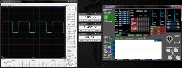

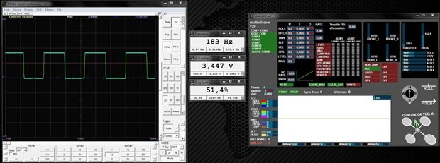

For example, I made a few screanshoots of MultiWii GUI and the testimony of the oscilloscope in one of the channels:
Thorttle = 0:
Throttle > 0:

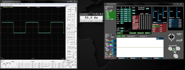

I also measured the signal using oscilloscope from the YAW-output (servo), in the case of tricopter configuration:

3. Writing the signal from the motor[] array in to the motors (EXT_MOTOR_RANGE is using for DC motors):
void writeMotors(void) // [1000;2000] => [32000;64000] * 256 (~190Hz motors!)
    #ifndef EXT_MOTOR_RANGE
        PWM_RR_WriteCompare( motor[0] << 5 ); //  Rear Right (Tri: Rear)
    #else
        PWM_RR_WriteCompare( (motor[0] << 6) - 64000 );
    #endif
        PWM_FR_WriteCompare( motor[1] << 5 ); //  Front Right (Tri: Top Right)
    #else
        PWM_FR_WriteCompare( (motor[1] << 6) - 64000 );
    #endif
        PWM_RL_WriteCompare( motor[2] << 5 ); //  Rear Left (Tri: Top Left)
    #else
        PWM_RL_WriteCompare( (motor[2] << 6) - 64000 );
    #endif
    #if (NUMBER_MOTOR > 3)
            PWM_FL_WriteCompare( motor[3] << 5 ); //  Front Left
        #else
            PWM_FL_WriteCompare( (motor[3] << 6) - 64000 );
        #endif
    #endif
