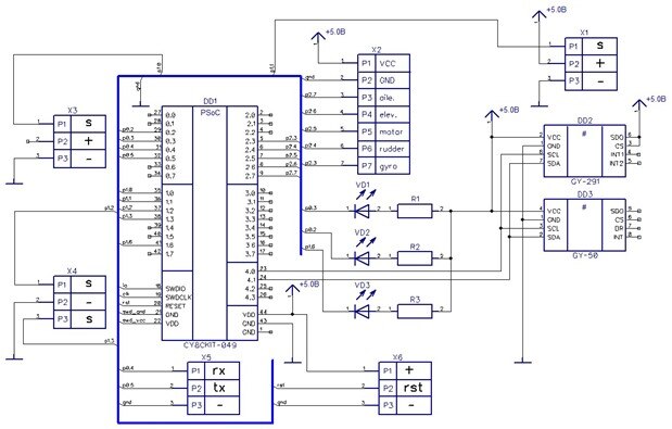

  • Schematics were developed;
  • PCB layout was made;
  • PCB was made in the old-school style image
  • Pioner Kit was turned into a convenient programmer for external PSoC chips.

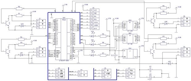

1. Initially I wanted to use PSoC at 3.3v, thus the following diagram was born, I used CAD-System DipTrace to draw it (schematics developed according to Russian standards, however, they differ a little from the western ones):
But after reading the datasheet, I found that in contrast to all "Cortex M" family MCU's, with which I worked earlier, the PSoC is able to operate at 5v! Circuitry was seriously simplified:

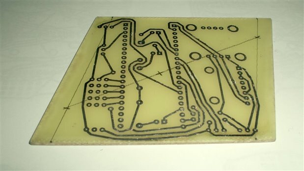

2. The next step was making the PCB, then I looked posts of other participants and saw that the level of performance was good enough! I decided to go the other way: to run the old-school tracing and to use a parallelepiped-shaped PCB. After all, we are having a creativity contest image
For tracing I used CAD-System TopoR (if you knew a little Russian, this name will make you smile). However the TopoR, Russian version of the DipTrace, and the OS Windows 7 Professional x64 have been refusing to be friends for a long time. But I wanted so much to make an unusual PCB that I managed to overcome this problem!
3. Captain Obvious reminds: December is the last month of the year! I am a PhD-student and I have a huge amount of work on the thesis. My printer worked in emergency mode and the day when I decided to make a printed-circuit-board, the printer suddenly broke down image

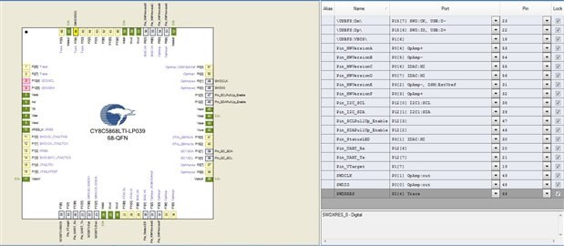

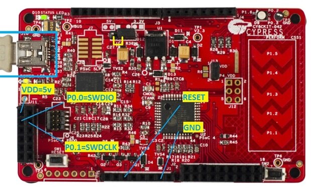

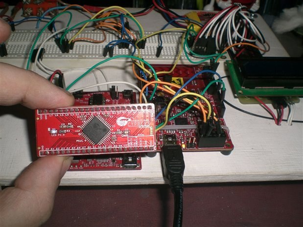

However, I found an activity: I understood that I need to flash the PSoC, and it will require the programmer. However, at the time of ordering components I forgot the programmer... I want to use the Pioneer Kit to program an external controllers. For this, I downloaded the firmware source code and decided to give it a little change, overriding SWDCLK and SWDIO lines thus to have access from outside:
However, this week gave me another surprise: the PSoC refused flatly being flashed! After long hours of torment, I found a solution!
In the original: SWDCLK = P2.1 and SWDIO = P2.0. I decided to override them on P0.0 and P0.1 respectively. Guess why? Exactly! At the end, after making SWDCLK = P0.1, SWDIO = P0.0 I was surprised to find that the programmer worked, Bingo!!!
4. Meanwhile, I fixed my printer. PCB was made (the photo was made before drilling and final grinding):

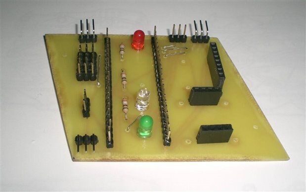

Next I bought  all the necessary components at a local store and soldered everything together:
Finaly, tricopter control system looks as follows:
I yet did not drill the mounting holes, because I still don't have the frame...
Did you notice the location of the LEDs? Yes-Yes, this is also an echo of unusual design image
