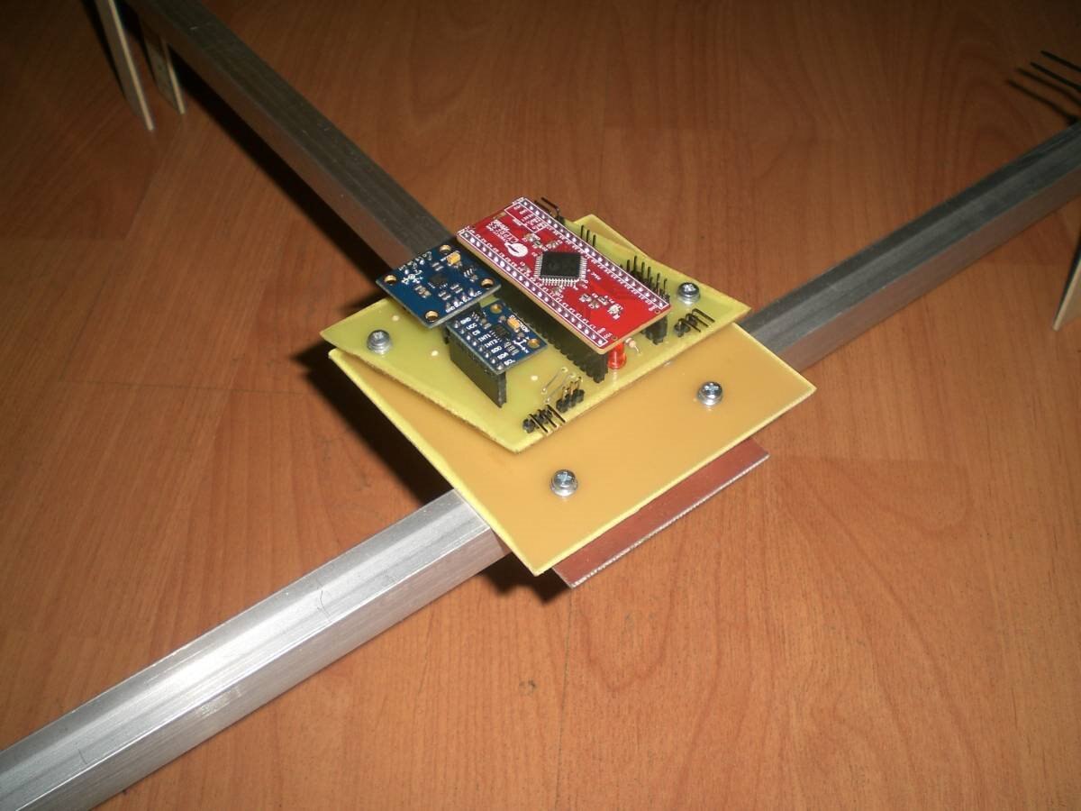

1. Let's start with the current situation on the construction of the tricopter's frame. In my case it consists of the following components:
  • aluminum square tubes: 15x15x600mm and 15x15x500mm;
  • two plates made of fiberglass;
  • landing legs made of wooden ruler;
  • M3 screws, M3 washers, M3 nuts;
  • plastic clamps.
Tricopter's features are already emerging:

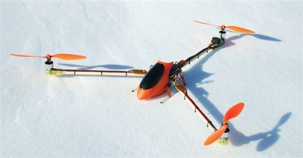

Originally, I planned to use an Y-type design, but afer making the T-type I really liked it! The frame seems to be strong and light.
To help you understand it better, here is an example of Y-type tricopter, which inspired me to build:
reference to the original source.

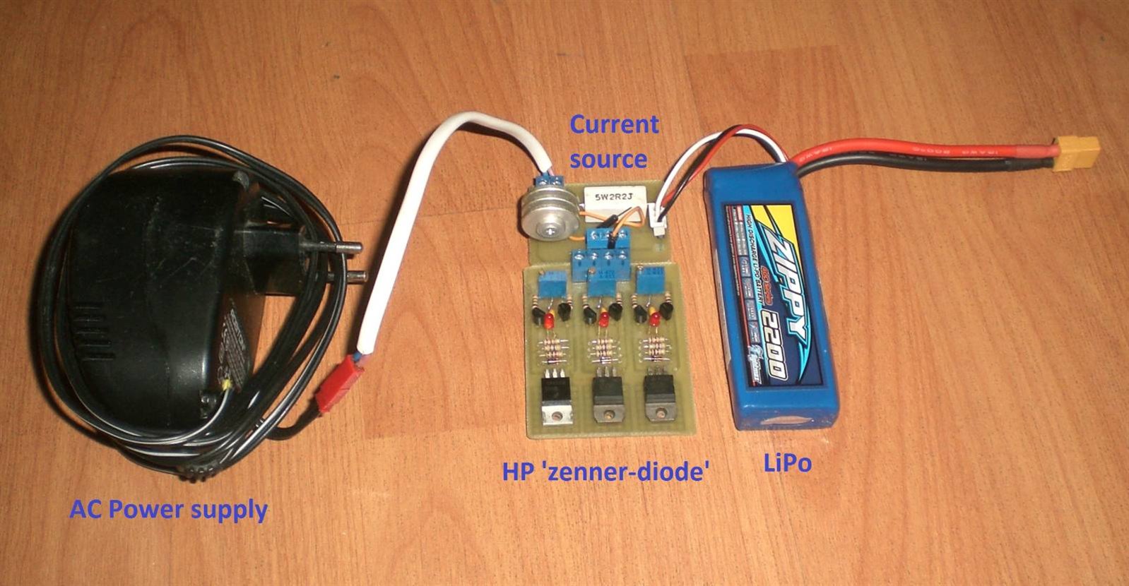

2. During the construction of our apparatus I'd forgotten a very important thing: charger for LiPo batteries. As its basis, I took the following scheme: link. Ultimately, of the materials I had on hand I built such a device:
Note: 'HP zenner-diode' is an electronic unit, which volt-ampere characteristic is similar to the high power zenner-diode (HP = High Power). In my charger are used three blocks of this type.

    yuritikhonov over 12 years ago in reply to DAB
    Thanks for you comment DAB!
    1. I agree, these stuff looks a bit heavy, but in real it is lightweight! Such tubes are now very popular in quadcopter's and I think they are suitable for tricopter.
    2. About balance: the balance will be good, because in addition to the front, I have a heavy battery and YAW mechanics. Moreover, the motors are arranged at equal distances from each other.
    3. The total mass of the device will be 700-850 grams, so I have a field for experiments image
    DAB over 12 years ago
    Hi Yuri,
    The aluminum pieces look a little too heavy to me.  Plus your configuration will change the balance equations for a tricopter to stabilize the airframe.
    I will defer to your experience, and look forward to your first test flight.
