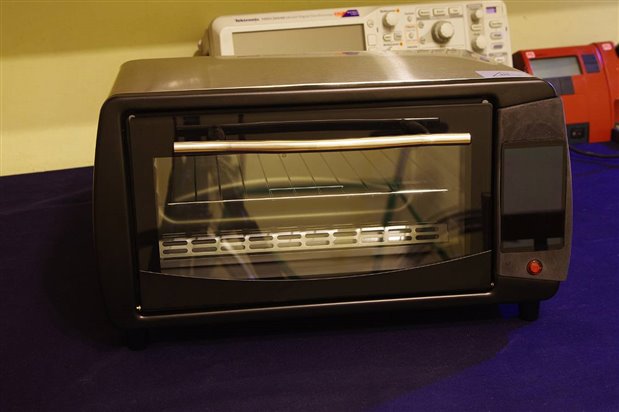

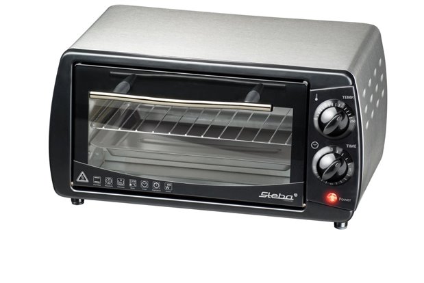

mini IR oven for my project. Its 800W and it has nice flat side for touchscreen mounting. Problem is, it will "just fit" with not much place around.
Also, all markings will be removed, and if all goes well, i have access to laser engraver for some custom markings ( in university we have laser marking machine ). Biggest problem is that i have very little room for my PWM controller, 12v power supply and my driver. I bet i have to integrate all electronics on single pcb and also send it to OHS Park for manufacturing, so not much time to spear image

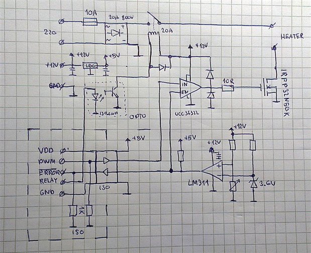

Heater power control
As you might know,i will use PWM control, so i can adjust heating power , and by doing that i should get better temperature control ( low temperature "ringing" with flat temperature profile )
Idea is this. PSoC 5 will generate PWM signal by measuring temperature from sensors, and adjusting pulse width according to PID controller state. Set point will be controlled by STM32F429 via UART. At start-up, PSoC will check if driver has ULVO, if yes, displays error, since i can't run power mosfet with gate voltage below 10V. Temperature fault will not be used, since i have 100mOhms MOSFET and rms current is just 5A, that is very little of heat. ( maybe i will add more heaters to get faster heating curve, but for now original heaters will work just fine.
Simple schematic:

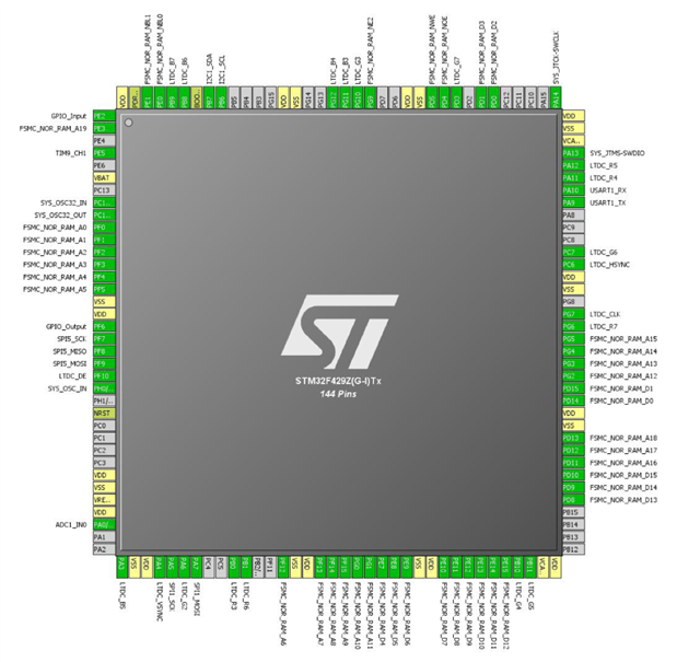

If some one still has a question, do i really need stm32f429i, here is the answer : (still, it's only for basic functions, more pins will be used in this design )

    heater control looks very problematic:
    1. you will be getting a lot of RF noise when trying to PWM high voltage power line.
    2. by using PWM you are also doing way too many on/off transitions on your IGBT which results in a lot of heat and the need for expensive IGBT.
    3. bridge is also generating a lot of heat.
    doesn't the heater run off AC? if so why not using a simple zero-cross enabled optocoupler + triac?
    this would be simple, would save some heat, but still not super efficient.
    and if it does need DC or you just want to make it very efficient, then you would be able to solve all 3 issues above by using 2 N-mosfets(4 if DC is needed) like this:
    http://1.bp.blogspot.com/-NhkIxnLAraY/Ty2HT74B3cI/AAAAAAAAAEg/kzvyyHG3at4/s1600/ac+main+switch+mosfet+app.JPG
    i used similar schematic for a dimmer and it makes basically no heat - if switching on zero cross you should be able to use 2 mosfets with no heatsink at all, saving not only power but space and cooling issues.

    I will get heat only on bridge rectifier, since form my HV work, i have many high power FET/IGBT transistors.  I can do zero switching, but that would mean i have very small control over heater ( i know, it would work just fine, but i have no experience on SCR ). I can use pulse picker topology for heating control, but that will add some complexity. PWM is simple and effective from design time perspective it is already working since all i need is to set duty cycle, and PWM will do all magic, no measurements, no other task are needed for heating control. Downside as you mentioned is RF noise and Heat, but i can live with that

    Think of ZC based switching as a PWM with 50Hz clock image
    you could use PSoC's hardware PWM and take external zero cross signal as it's clock source.
    From software point of view the result would be more or less identical to high speed PWM solution - same duty cycle control as before.
    But there would be no RF noise, and depending on switching solution, less heat problems.
    Heating element is slow to respond anyway, so you're not loosing any features by using slower PWM.

    That is good idea, i will try that on my bench, and see if it works, but i have to use zero cross detector from power supply transformer to get reference for 50Hz.
    But still, backup plan is PWM control, since soon i should get parts for this project, and i will test how much RF kickback and heat i will get from my PWM controller. I know that heating is slow, but what is better, to get low frequency noise because of on/off action (flickering lights as example), or get small RF noise coupled into mains, but power draw would be very constant ? ( and LC filter will clean most of RF anyway...). and by using PWM i can mimic PFC  by adjusting dead time on zero crossing

    Last time i did PWM on mains over rectifier I nearly burned my favorite IGBT image
    But I'm sure you can test and see what happens using your load and your IGBTs.
    As for Zero Cross there are many ways to get it. In atmel datasheets it's mains connected to a digital input pin over 1meg resistor image
    I myself used one simple yet elegant optocoupled solution with small offset and one very precise with comparators in another project.
    I guess that using integrated PSoC comparator would earn you more points in this project than using external solutions image
    Try it out on your bench - depending on where will you tap into on your PSU you can use PSoCs comparator and maybe even opamp to get a very precise ZC signal.

    If using zero cross based control, you can configure your PWM so that it's cycle length matches 50Hz and so you would always turn transisor on during ZC but turn it off sooner or later based on duty cycle.
    What i'm trying to say here is - use trailing edge dimming equivalent:
    http://my.coolala.net/upload0713/2010/340/1291717773.jpg
    this way you will not have any noise at all - high or low frequency.
    it would look something like this:
    PWM clock matching 8bit range over 10ms cycle.
    PWM configured for one-shot run activated by trigger (not sure if reset is needed after mosfet is turned off, but that's just a matter of one more virtual wire image)
    Primitive ZC implemented by comparator, comparator triggering on both, rising and falling edge.
    Add IGBT driver of your choice and double check all the stuff as this is just an idea on paper, not something already built.
