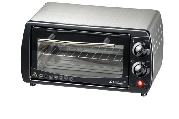

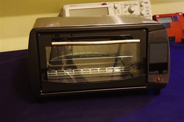

mini IR oven for my project. Its 800W and it has nice flat side for touchscreen mounting. Problem is, it will "just fit" with not much place around.
Also, all markings will be removed, and if all goes well, i have access to laser engraver for some custom markings ( in university we have laser marking machine ). Biggest problem is that i have very little room for my PWM controller, 12v power supply and my driver. I bet i have to integrate all electronics on single pcb and also send it to OHS Park for manufacturing, so not much time to spear image

Hrr, is is very hard to make nice looking front panel. I have no room for any mountings, also very little room for AMOLED itself.
Plan is to use FR4 sheets, cut it with cnc, and glue them . For now it's my only option

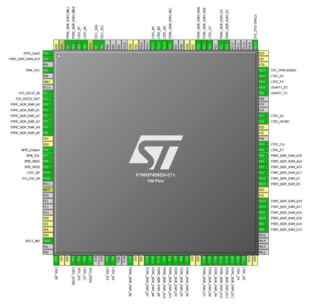

If some one still has a question, do i really need stm32f429i, here is the answer : (still, it's only for basic functions, more pins will be used in this design )
