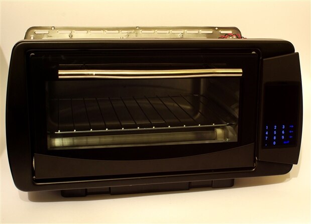

2 days work on exterior and today i can say, it turns out better than i expected . Now only UI programming is left, RTC, PID,PWM are working and i can do reflow soldering even today, but i need to make clean UI.
Still don't know how can this project be completely ignored by in this contest, but where is other contest on STM32F429 that needs to explore DMA2D peripheral and what is exactly what i need for my user interface, alpha blending for 2 temperature graphics, also transparency for on screen keyboard and so on.( but i am running low on SRAM, so it could be a challenge )

    i don't know how to do gradient fillings , and also color mapping by only using c code. It would be easy to make it look like window 98, but i am going for windows 8 look if you know what i mean
    right now i have concerns about:
    making temperature graph that looks good, and still is informative, not just plain line, but something more, like blend two graphs from T1 and T2 with color map by suing alpha blending.
    Second how to write keyboard application that can return data in right format, and jump between windows (text box). I am also have problems with double interrupts, like how to understand that i pressed button only one time, and not 20.
    Third, graphical layout of all settings, check boxes, and so on.
