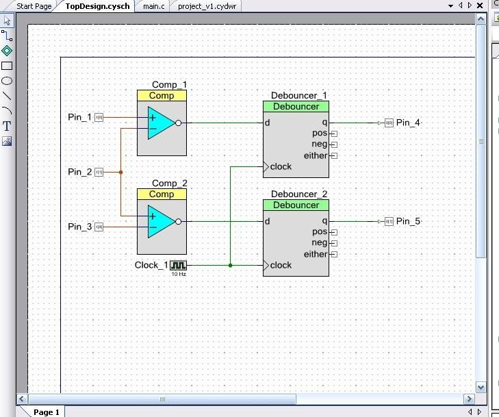

Then the problems started: I realized that I need a window comparator (this was based on the measured waveforms that I showed in my previous update).  So I configured it using the two comparators inside PsoC4, but when I tried to build the project I’ve got a resource availability error.  So then I figured out that I cannot use two comparators and an opamp; only either two opamps, two comparators, or one opamp and one comparator.
Next I moved the filter off-chip and I built a window comparator using the two opamps/comparators inside PsoC4.  Then I realized that I could eliminate the low-pass filter for now if I use a debouncer block available in PsoC4.  I setup a 10Hz clock to the debouncer and here is the schematic:
I then routed the two outputs of the window comparator off-chip to two LEDs (in series with two 2.2k resistors).

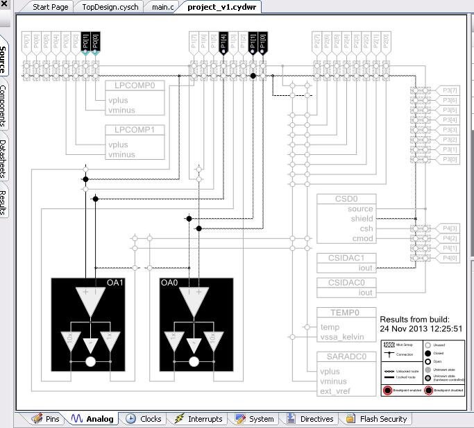

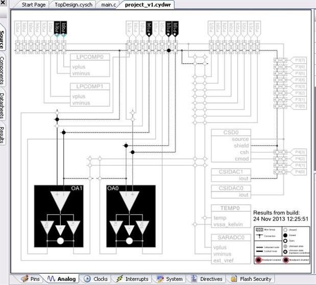

So I started to troubleshoot this issue and after more than one hour I figured out what was happening:  PsoC Creator program was “optimizing” my project by removing one of the opamps/comparator.  During the troubleshooting pricess I found useful the diagram shown under the “Analog” tab in the pin mapping frame:
This one looks correct but the wrong one, which I did not screenshot, showed one opamp without one of the input connections and also was signaling a warning that one of the pins (that pin that I wanted routed to the opamap) is not connected.  Further tracing this issue I found out that the optimizer removed one of my opamps.
So after about 1.5-2 hours of poking around I came up with a solution: the only think that worked was to start a new project from scratch.  This fixed the problem and I’ve got both of my opamps in the built project.
