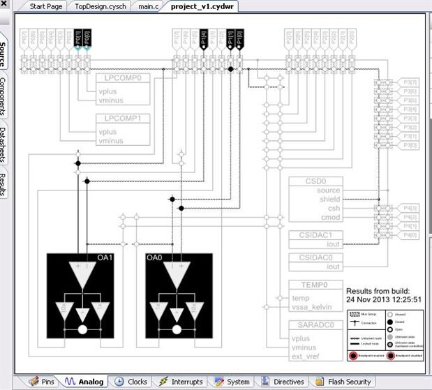

So I could built this project and program the PsoC on the Pioneer kit.  Then while running various experiments and re-building the project, at some point my circuit stopped working.  One LED never turned ON.
So I started to troubleshoot this issue and after more than one hour I figured out what was happening:  PsoC Creator program was “optimizing” my project by removing one of the opamps/comparator.  During the troubleshooting pricess I found useful the diagram shown under the “Analog” tab in the pin mapping frame:
This one looks correct but the wrong one, which I did not screenshot, showed one opamp without one of the input connections and also was signaling a warning that one of the pins (that pin that I wanted routed to the opamap) is not connected.  Further tracing this issue I found out that the optimizer removed one of my opamps.
So after about 1.5-2 hours of poking around I came up with a solution: the only think that worked was to start a new project from scratch.  This fixed the problem and I’ve got both of my opamps in the built project.
