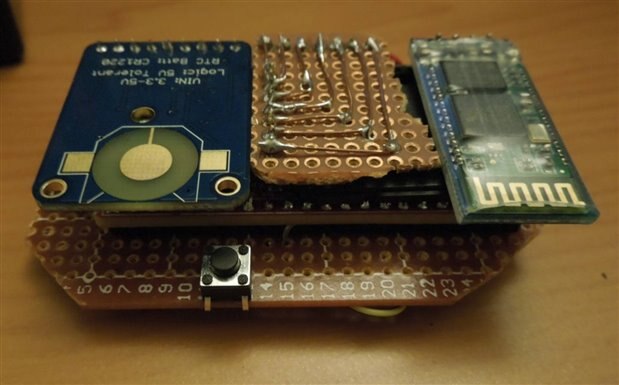

Prototype 1.2 - Button is used to activate bootloader for programming
On the top left is the GPS (upside down to reduce overall height.
On the middle is the SDCard, it is just wired up to a microSDCard jacket that holds a 2GB microSD card
On the right side is the bluetooth module. For this prototype the baud rate for the bluetooth was increaded to 57600 instead of 9600 on the first one for faster data transfer. Since the bluetooth is connected to the Rx and Tx pins that receives the new file for in field programming. In order to reprogram the board this board has to be taken out and wire the serial wires. Originally I wanted to update the board firmware via bluetooth but for some reason it doesn't work so I have to wire a regular usb serial adapter to where the bluetooth module is connected.
If look carefully there a pcb in the middle that holds the PSoC4.

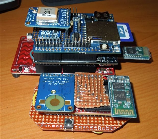

Side by side from first prototype to second prototype. Only components missing on smaller prototype is the accelerometer but apart of that is the same, way smaller right!

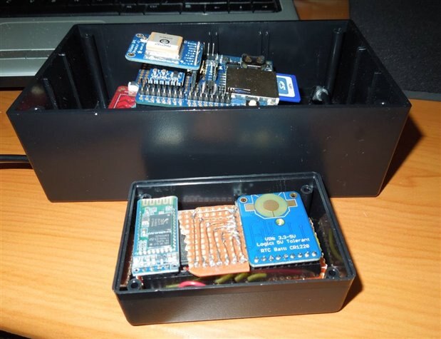

Project box greatly reduced. Small project box shall have a usb cable for powering the device (not shown here).

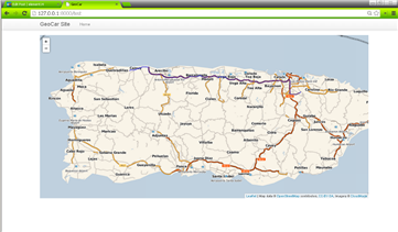

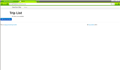

This is the main page of the application. Here data should be separated on trips to show the plotted data. However for now the only option that is programmed is the the blue button that shows all the recorded data. This page is programmed in django and it has a rest api that allow the upload of data from a client. For development the database is in sqlite but any database supported by Django may be used.
The purple line (the API said blue but I see it more close to purple) is the actual data recorded from the PSoC. There are a bunch of dots from more than one trip. Actually there are 1 GPS location for every 5 seconds on the trip.
