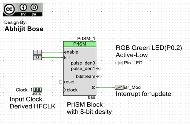

Here is the Application Schematics:

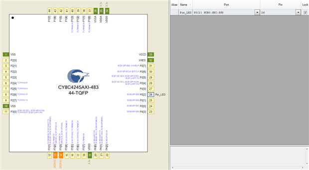

This example uses the PrISM module as the sole control of the LED output as well as the interrupt source to update the LED intensity(called Density in the program + PrISM API).
The internal timeout of the PrISM module is used to activate the ISR for the LED intensity update.

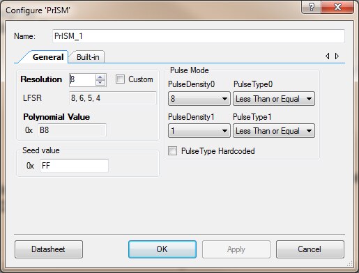

The PrISM module { PrISM [v2.20] } Settings are as follows:
