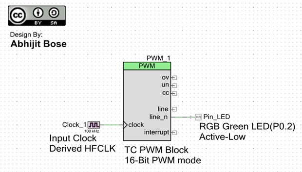

Here is the Application Schematics:
This example uses the PWM block in a timed configuration to produce the dimming effect on the LED.

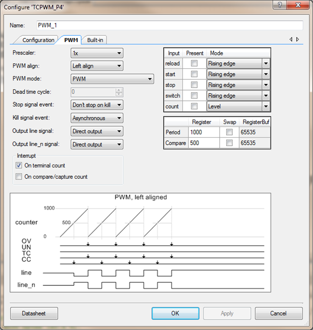

The PWM module { PWM (TCPWM mode) [v1.0] }configuration is as shown below:
In the code one needs to vary the Compare factor for the PWM to generate a DC average output that would lead to dimming of the led.
Ideally a capacitor is needed to produce the DC averge but since the LED load is not significant, its possible to directly generate the dimming on the pin connected LED.

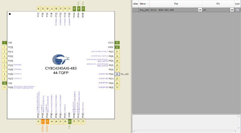

After building and loading this code the Green LED on the Pioneer Kit would show the dimming effect.
Its important to note here that this dimming would show up some visible blink and may also cause EMI/EMC or RFI issues in case the output is used to control LED drivers.
The better solution would be use the PrISM module to generate precise dimming without flicker or emission issues.
