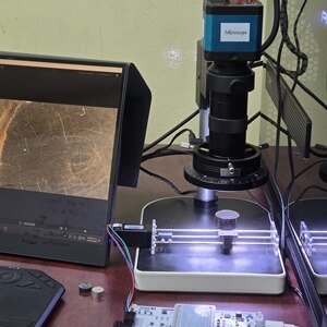

It is required to design a mobile stage for XY movements in a metallurgical microscope. The initial proposal consists of a one axis stage controlled by the TMCL-IDE for displacement and the camera software for acquisition.

The nature of these processes allows the multiple proposals to be tested simultaneously in the entire system and select the best assembly to be used with the microscope and with the assistance of the TMCL-IDE, move the samples and throughout the field of view and acquire multiple images of the same sample. This example is shown in the next section.
| {gallery}Proposals |
Testing proposals
The final stage of the challenge at the moment of writing this project is the visualization of the stage functionality. First, it is necessary to configure the current sensing in the motor board. To do this, both sensing configurations are shared, consequently, the motor 1 must be validated to be able to measure current correctly and confirm this configuration on the motor 2. This is required since the two motors have similar characteristics. For testing proposals, a current of 402 mA is configured for a 15kΩ reference resistor. This window is available clicking Device > Motor 1 > Current Settings
Once the configuration is correct, the video capture software, in coordination with the TMCL.IDE software, takes a complete shift of the image. Like many prototypes, the first proposal has misalignment errors that will be corrected in future releases of the project. On the other hand, the TMCL software can be configured to loop motion and capture a complete video reel for future analysis, or position the sample and capture individual frames.
Finally, a complete motion loop and video capture is shown below

These test demostrate the feasibility of the stepping motor usage with the Trinamic platform for positioning and image capture with good enough quality. The prototype needs to be improved and a better material selection and manufacturing could reduce the error on the dynamic behavior of the X-axis stage. In addition to these, a second Y stage should be added for full-frame acquisition and a possible Z axis for the focal length compensation. I am grateful for the support of the project by the sponsor, who provided the motor controller and accessories. Finally, the project is continously improved and designed; I hope to use the encoder interfaces for closed-loop control soon.
