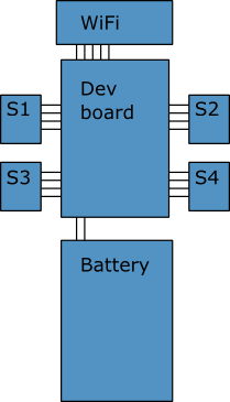

My plan is to make a modular and easy to configure prototype. It will also have to be accurate and should provide realtime sensor data.
In my initial post I explained my plan only in rough words. I will now try to be more elaborated about the hardware components.
1) Remote units
a) MCU and wireless connection
Remote units will be based on a small development module.
Until I receive my kit I will not make the final decision regarding the development board that I will use. ADuCM350 might be sufficient since it provides a powerful processor and plenty of GPIO pins but if that turns out to be a problem for whatever reason (it’s probably too big), I will select Arduino Pro Mini as it features small size and a lot of IO pins I can use. It’s based on a well-known MCU. It does not include USB to Serial converter, which is also a plus (decreases both size and unit price). Prototyping is easy using Arduino IDE.
For communication with central unit, cheap ESP8266 breakout board (ESP-03 variant) will be used. This is a Wi-Fi module made by Espressif. I selected a variant with no headers to make the smaller device and a ceramic antenna to make better transmission range. Some range tests were performed for this module and here's the result of one of them: https://www.youtube.com/watch?v=7BYdZ_24yg0#t=385. This should be good enough for almost any kind of sport field - for additional range, additional repeater access points could be setup in the field.
Remote units will be equipped with sensor modules connected using wires. If I get to the point that I need to communicate with some sensor wirelessly, BLE connection will be used. Connected sensors will be enumerated at startup and list of them will be published to central unit.
Figure 1. Remote unit

    mcb1 over 11 years ago in reply to hlipka +4
    We have commercial alarm sending units at work. The time is centralised, and at each communication it sends the time, but inbetween they run on their own time, and stamp the alarms with the detection time…
    DAB over 11 years ago +2
    Hi Dragan, You might also want to set up a clock on the board to put your data sampling on a time base. That way, you can look the body fatigue issues along with impact. There might be a correlation to…

    hlipka over 11 years ago in reply to tomaja +1
    If your remote units are always in the transmission range to the central unit, this might be fine. Otherwise they would need to store some data and transmit it later on, then you need a timestamp. Also…

    tomaja over 11 years ago in reply to mcb1
    Mark, you also have a good point here!
    Having clock on the remote units (synchronized with central units time) will provide me with some insight about communication quality which I wouldn't have otherwise.
    Thanks for the idea!
    And thank you DAB for pointing it out in the first place.
    Dragan

    tomaja over 11 years ago in reply to hlipka
    Thanks for sharing your thoughts.
    I agree that adding RTC to remote devices will provide more possibilities so I will certainly include it in the final design.
    Well, to be honest I was hoping to use some existing and proven solution (like MQTT) instead of developing my own. I was hoping that it will be good enough for this task.
    Having up to 30 remote units running at a time should result in stable connections with no major delays (with 1-2Hz update frequency). Anyway, this will be very easy to simulate at an early point in development so I can switch to plan B if it turns out that BBB or RPi can't handle that traffic. 1 or 2 samples per second should be enough with additional transmissions in case certain criteria are met (e.g. accelerometers support interrupts).
    Dragan
    The time is centralised, and at each communication it sends the time, but inbetween they run on their own time, and stamp the alarms with the detection time.
    You may be able to include the "detection time" (device time) and the "reception time" (central time) in the stored data.
    It may provide some additional information about the communication quality, and provide flags when comms has stopped for some reason.
    If your remote units are always in the transmission range to the central unit, this might be fine. Otherwise they would need to store some data and transmit it later on, then you need a timestamp. Also, when multiple devices are sending data streams, the central device might get overwhelmed and data might get out of sync.
    And MQTT as queue solution is not synchronous anyway...

    tomaja over 11 years ago in reply to DAB
    Hi DAB,
    Thank you for your suggestion.
    What do you mean? Real time clock as additional module connected to each remote board?
    I was planning to use central unit time to assign the timestamp to each data sample. Do you think there's a problem with that?
