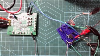

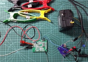

Setup:
Image of the full setup -                                                    Analog Front End AD8232 and Electrodes -
Conventional Ag-AgCl electrodes were used for this experiment.
Supply and Isolation -
The Breadboard circuit is to provide the required 3.3v supply from a 6v battery and the opto isolation circuitry to observe the signal onto a scope without connecting it’s GND with the AFE. This keeps the signal clean from noise and also provides the minimum medical safety.

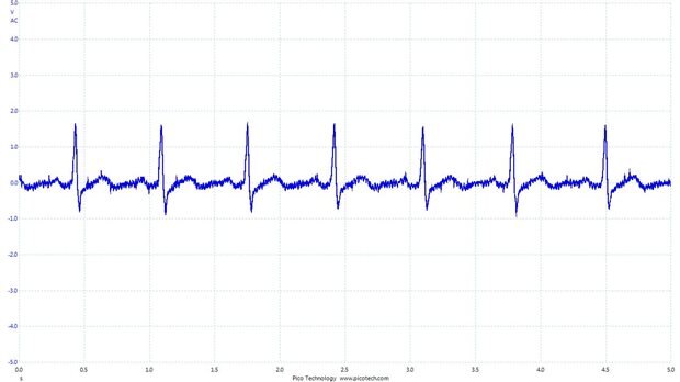

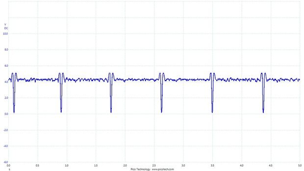

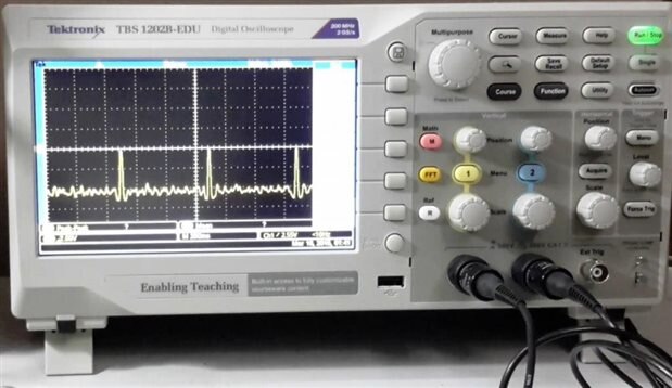

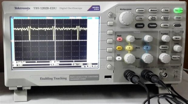

ECG output:
The captured ECG signal from AD8232 displayed on TBS1202B scope with 250msec time scale. The signal was inverted due to the use of opto isolator. By inverting the scope input I got the conventional output.
Output analysis:

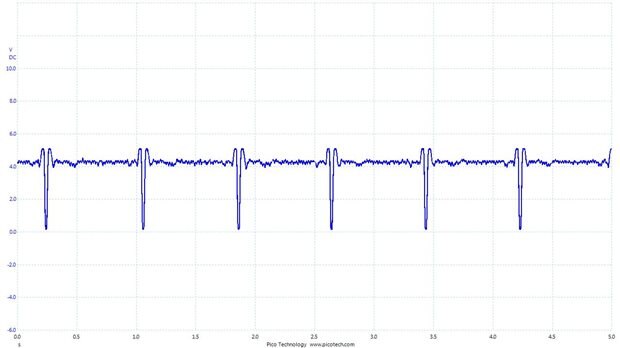

The output of the AD8232 was taken as the Fast Response switch was disabled.
With enabling the Fast response switch I got an output almost similar to the previous one.

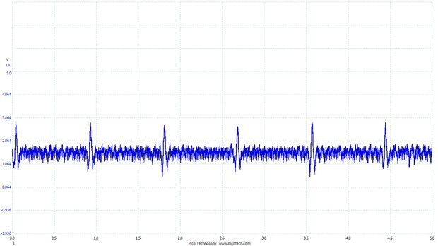

If I compare the output of AD8232, with the primary AFE designed by me then I can observe some differences.

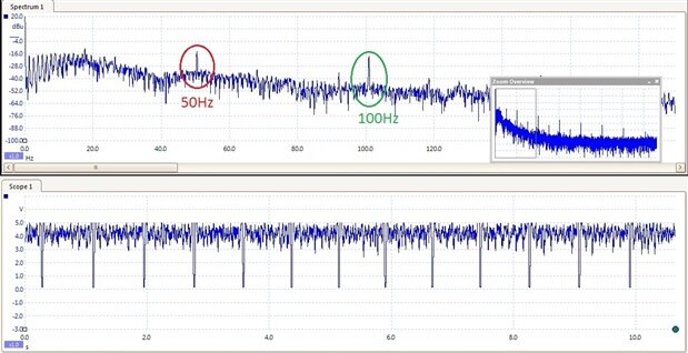

This was the output of the primary AFE. It shows that the AD8232 is missing detail information in the signal. Like the P-wave is flatten and the whole T-wave is superimposed with the 50Hz noise.
May be that’s because of the filter bandwidth. In my design I had captured in between a range of 0.3Hz to 159Hz where AD8232 limits the low pass far below 50Hz to get rid of common noise. However, this won’t be necessary as it’s not for diagnostic purpose. I just need to get the heart rate with single LEAD ECG, so it’s pretty good enough. Moreover, AD8232 produces a better, sharp QRS complex which will be more helpful.

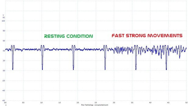

However, AD8232 responded effectively for removing motion artifacts. For general movement, it maintains the output signal pretty good. But for fast strong movements or contraction of the muscle the signal gets distorted. I have to check it's performance over motion artifacts once again after mounting it on human body.
All the outputs of the AD8232 is presented inversely because of the opto-isolator. The original output without isolator looks like below, where the 50Hz noise is added from oscilloscope.
Spectrum view:

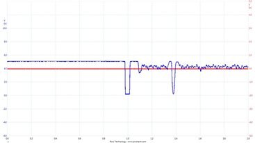

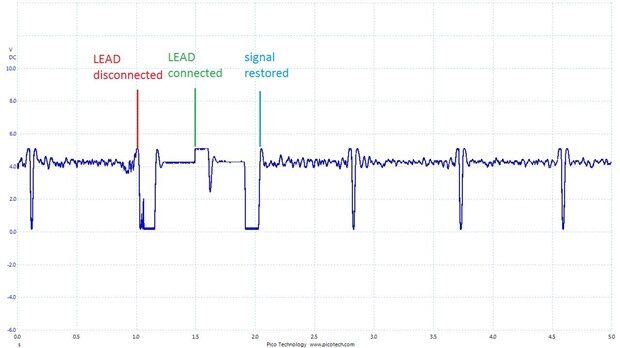

Fast response:
With fast response enabled, the output was restored almost immediately after reconnecting the LEAD. With fast response disabled, the output becomes steady after about 0.5 to 1.5 seconds.

The shutdown feature works perfectly.
     image: Shutdown is turned on.                                        image: Signal restored after shutdown is turned off

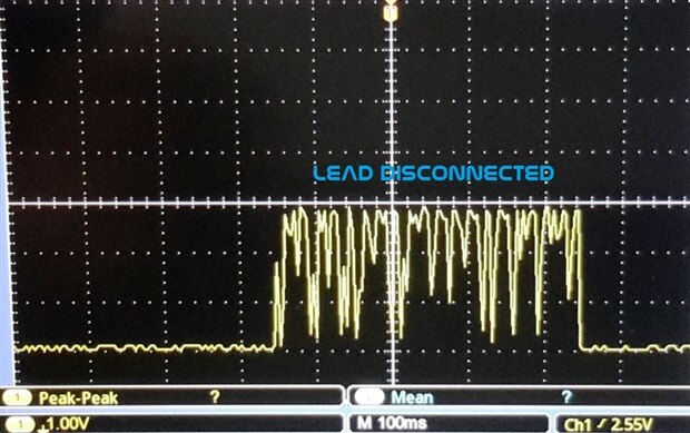

LEAD off detection:

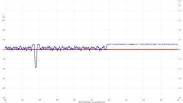

  Unfortunately, the LOD+/- didn’t perform as I thought. I placed the switch into DC position and removed one LEAD. I was expecting something like a digital high/low output swing. But when the LEAD was taken off the LOD output started oscillating.

    for large and fast movements the signal also gets distorted for me. but I would like to work on it. so, I'll try to find the optimum placements of electrodes and beat detection algorithm.
