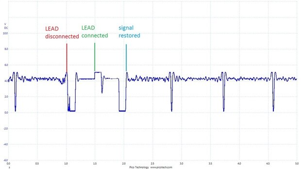

With fast response enabled, the output was restored almost immediately after reconnecting the LEAD. With fast response disabled, the output becomes steady after about 0.5 to 1.5 seconds.

LEAD off detection:
  Unfortunately, the LOD+/- didn’t perform as I thought. I placed the switch into DC position and removed one LEAD. I was expecting something like a digital high/low output swing. But when the LEAD was taken off the LOD output started oscillating.

         1) [S1] FR - fast response disabled [right side], [S2] LOD - lead off detection switched to DC [right side], [S3] Shutdown - disabled
              it gave me the output without fast response. so when I removed one of the three electrodes, and then replaced it back - the output took about 0.5 - 1.5 seconds to get restored back.
         2) FR - enabled, LOD - DC, Shutdown - disabled
              it gave me a better and quick response to immediately restore the ECG signal after removing and reconnecting an electrode.
