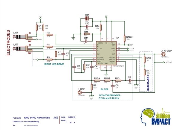

Hardware:
AFE --> AD8232 with 7.2Hz to 2.28KHz bandwidth.
Gain --> 1100 [inamp = 100, filterout gain = 11]
RLD --> R7 has been used to limit the loop gain for DC or low frequencies.
Shield --> Electrode cables are shielded with RLD output. Bottom layer of the PCB on the AFE side is copper
filled with GND to reduce the noise

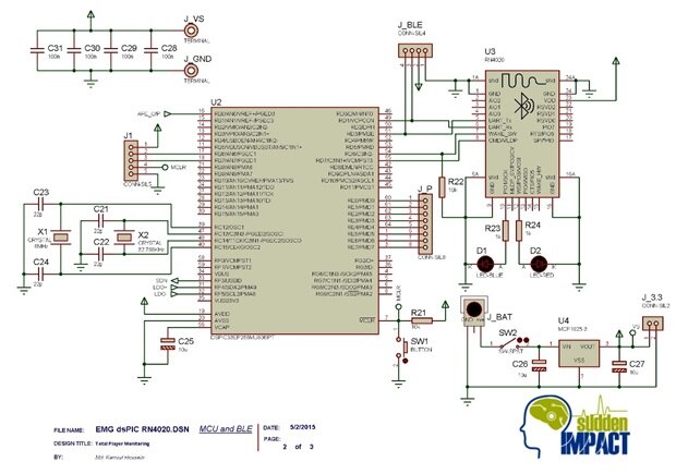

MCU --> a dsPIC33EP256 microcontroller is used to process the output signal from the AFE and to extract the amplitude variation of the compound action potential from the muscle, which will give us the magnitude of activity. It also controls the Bluetooth communication.
BLE --> RN4020 from microchip
PCB dimension --> 5.4cm x 3cm double layer
Circuit Diagram:
Analog Front End -->
MCU and BLE -->

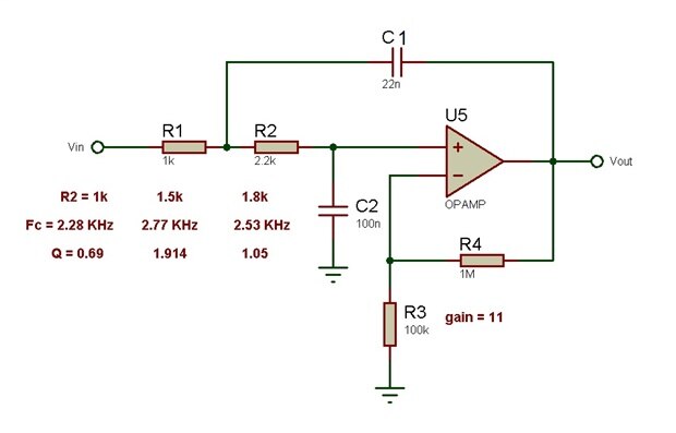

Filter Design -->
  • Two pole low pass filter
  • With gain
  • Sallen-Key topology
The high pass filter is kept unchanged from ECG AFE design [7.2Hz], as EMG signals has lower frequency components of about 10Hz.
For ECG, the low pass filter cut-off was designed at about 25 Hz. But EMG from surface electrodes can have higher frequency components of about 1KHz. We can get upto 10KHz from needle electrodes, but here we are using surface electrodes. That's why the filter cut-off is set to about 2.28KHz.
Transfer Function -          G(s) = 2272727272.73 / (s2+20661.1570248s+206611570.248)
fC = 1/(2π√(R1 C1 R2 C2))
Gain = 1 + R3/R4
However, I have found that there is a mistake in the user guide of the AD8232 about the equation of 'Q'. It made me confused at first, but I have got the original one in the datasheet.
now for different value of R2 we get different fc and Q -
R2 = 2.2K
Cut-off frequency                    fc = 2287.69145929[Hz]
Quality factor                        Q = 0.695701085237
Damping ratio                       ζ = 0.71869946822
R2 = 1.5k
Cut-off frequency                    fc = 2770.53194272[Hz]
Quality factor                        Q = 1.91485421551
Damping ratio                        ζ = 0.261116483934
R2 = 1.8K
Cut-off frequency                     fc = 2529.13806886[Hz]
Quality factor                        Q = 1.04880884817
Damping ratio                        ζ = 0.476731294623
R2 = 1.8K matches the best with the Q of the original filter of AD8232 evaluation board for ECG [Q=1.43]. But I don't have the SMD 0805 version of 1.8K, so I have tried with 2.2K.

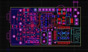

PCB:
The PCB design is the same as the ECG module, where only the passive component's values will be changed.

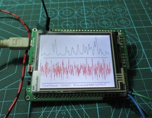

EMG Output:

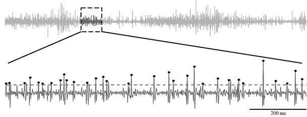

As this design is intended for monitoring only the muscle activity [for the time being], the processing of the signal is kept pretty simple. The goal is to get rid of common 50Hz noise and emphasize the compound muscle action potential [MAP]. The amplitude of the compound MAPs represents the activity rate of the calf muscle.
The second order low pass filter [sallen key], implemented in the hardware, has a cut-off frequency of about 2.28KHz. But this will be needed when we'll work with wavelet analysis where the wide range of signal information will be needed for pattern recognition.
But for general activity monitor, we can get enough information far below 100Hz region. So, we'll implement filter with lower cutoff within firmware. After the Pre processing and conditioning part, we need to rectify the signal and apply a smoothing average filter which will significantly emphasize the MAP peaks. At the end different threshold limit can be implemented to differentiate between activity level depending on the amplitude of the processed MAP peaks.

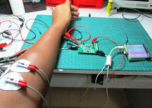

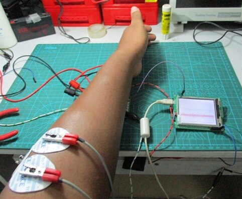

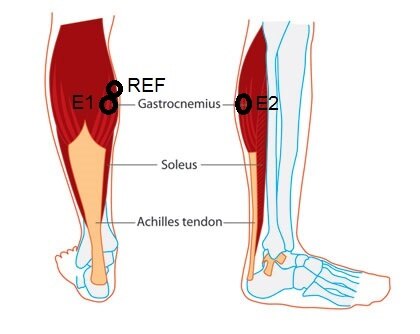

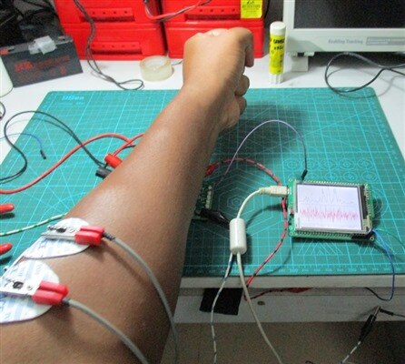

** this experiment was performed placing the electrodes on my forearm. It helped me to easily demonstrate the output. But in real life, electrodes will be placed around calf muscle.

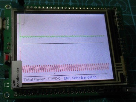

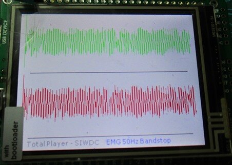

STEP01 [Pre processing]:
     Filter -> FIR Bandstop [50Hz]
     Order -> 32
     Stopband1 -> 40Hz
     Stopband2 -> 60Hz
     Window -> Bartlett [triangle]

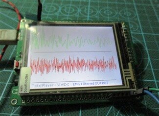

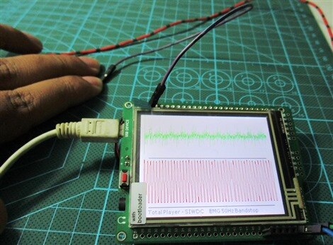

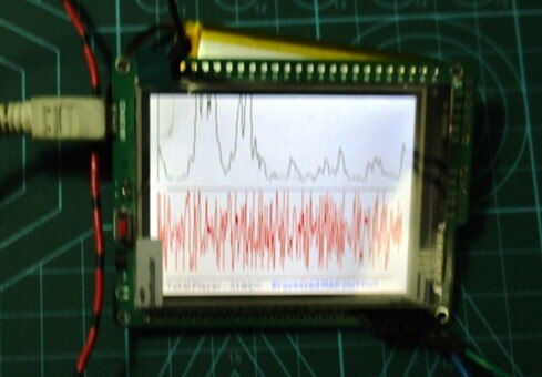

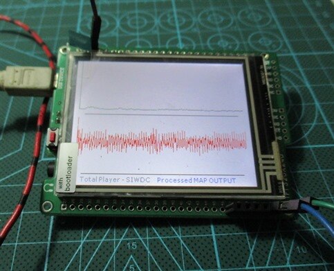

At first the input channel was kept open [floating with a wire attached] to check the performance of the filter against 50Hz. The RED plot represents input signal and the GREEN plot represents output signal.
Floating input                                                                                                             Input wire touched by hand to get large 50Hz signal

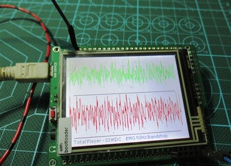

It seems that the FIR filter successfully reduce the common 50Hz noise. Now the input is connected with the output of the EMG AFE and compared the signal output of the Notch filter for both resting and active condition.
Resting condition                                                                                                         Muscle contraction

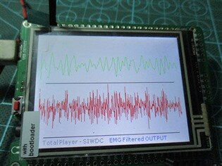

It slightly improves the signal by filtering out the 50Hz noise, but the high frequency components dominates the signal. For detecting the compound MAP peaks we don't need the higher frequency components. So, a Bandpass filter can do the job.

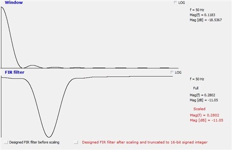

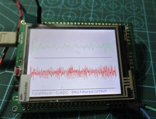

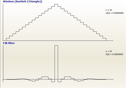

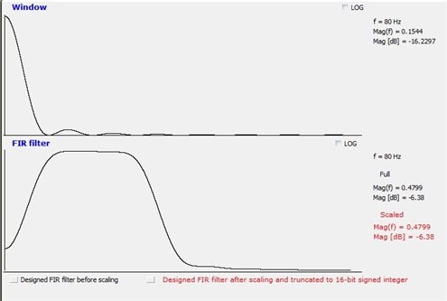

STEP02 [Condition]:
     Filter -> FIR Bandpass
     Order -> 32
     PassBand1 -> 12Hz
     Passband2 -> 80Hz
Filter response -
Filter output at resting condition                                               At contraction                                                            At strong contraction

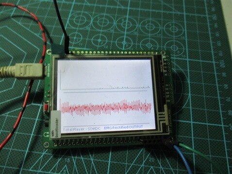

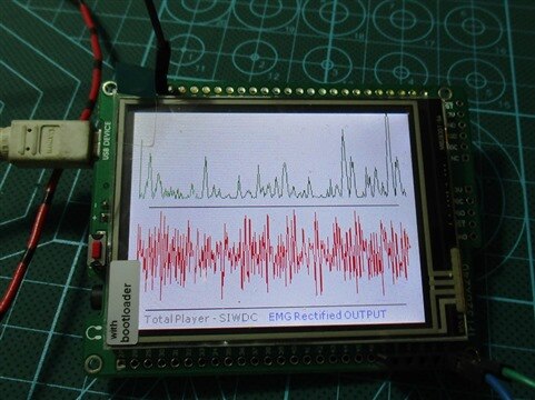

STEP03 [Rectify and Emphasize]:
After conditioning the signal, the compound MAP peaks are visible. By differentiating and squaring up, we can rectify the signal so that all the changes in amplitude stays in positive zone. It also emphasize the peaks to be significantly extracted.
At resting condition                                                                                                    At contraction

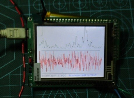

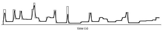

STEP04 [Smoothing]:
The rectified and emphasized output actually differentiate between lower and higher muscle activity. But it gives too much variation and several peaks stays in an active region where the overall intensity or strength of the activity depends upon the consecutive no. of peaks too. So, its better if we can apply a moving average filter with a certain time period, that can implies all the peaks in a certain activity zone. It will also help us to implement the amplitude threshold.
Close view -
But for calf muscle I have got large peaks which get out of the range easily when I have tried to make some jumps and stretching to put some load on my calf muscle.. This is because the raw EMG captured for calf muscle have higher amplitude than forearm. Therefore, I may need to reduce the gain of the Lowpass filter in hardware, so that the final output of the system stays in between the dynamic range.

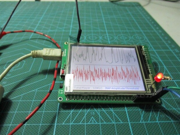

STEP06 [Amplitude threshold]:
just for experiment, an LED was turned on only when the detected peaks crossed the 80% of the highest limit.
