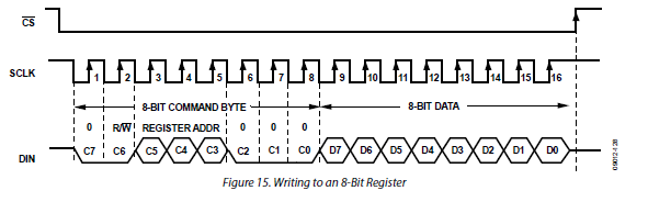

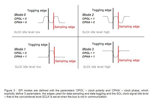

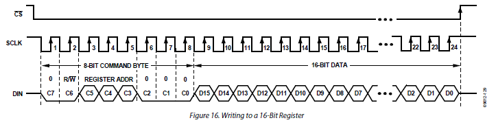

Protocol structure:

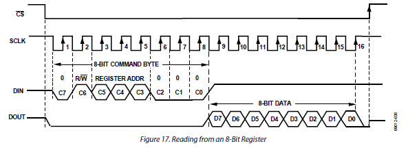

ADT7320 operates in Mode3, where the idle state = clk high and data sampled at active to inactive [low to high rising] state.imageimage
ADT7320 has both 8bit and 16 bit reading and writing structure depending on the size of the target register. But for every read or write operation, 8-bit command byte has to be written at first.
I have shown the writing and reading structure from the datasheet at the end of the blog.

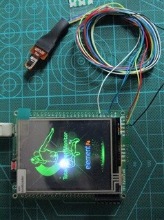

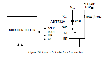

Hardware:
I am using Mikromedia board for demonstration. Unlike previous cases, this time I am going to use the dsPIC33EP microcontroller of Mikromedia board for this module. Because, I have other sub-modules like impedance measurement and plethysmograph, where the DSP will be needed to process the signals.

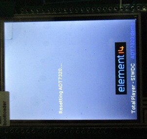

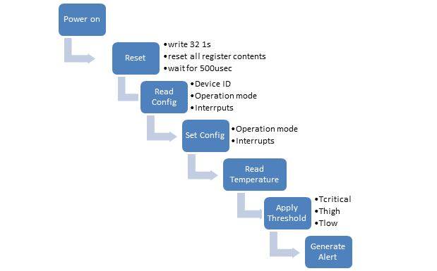

Step 01 - Reset:
After powering up the first step is to reset the SPI interface and reset all the register contents which ensures that the sensor is ready for stable performance.
To do that logic high [1] has been sent into DIN line of the sensor for 32 times.
         device setup                                                                                               reset ADT7320

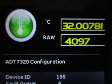

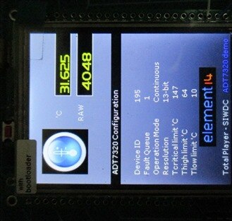

Step 02 - Read Configuration:

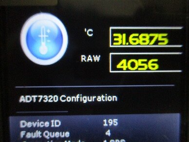

After resetting the sensor it's better to read the configuration  to see whether the operation mode is in expected form.image
First to check the device ID.
command byte frame for reading the device id :
01011000             ->            0x58 hex
C7
C6
C5
C4
C3
C2
C1
C1
0
R/*W
Register address
0
0
0
0
1
0
1
1
0
0
0
IDT7320 responded with 195 = 0xC3 hex, which was expected.
Then the 'Configuration' register gives the operation mode for ADT7320.
command byte frame for reading the configuration :
01001000             ->            0x48 hex
C7
C6
C5
C4
C3
C2
C1
C1
0
R/W
Register address
0
0
0
0
1
0
0
1
0
0
0
The ADT3720 was running in default mode with 'continuous' data conversion at 13-bit resolution.
The Fault Queue was single fault to generate interrupt.
After that, the Temperature limits for interrupt generation were verified.
command byte for reading the interrupts :
T(critical) = 0x60 hex
T(high) = 0x 70 hex
T(low) = 0x78 hex
IDT3720 gave the default value of 147'C, 64'C and 10'C respectively
The right side image represents an example of reading temperature at default operating mode.

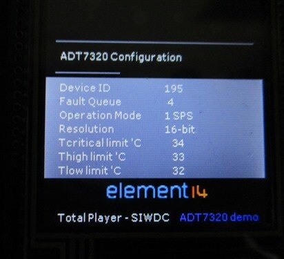

Step 03 - Set Configuration:
By reading the configuration I came to know that the sensor is running in 'Continuous' mode with 13-bit resolution. Now as I want to use the sensor in 16-bit 1sample per second for more precise output and less power consumption, I need to change the configuration register. I would like to change the temperature interrupt limits as well for demonstration purpose.
frames for new configuration register ->
     command byte  =  00001000 = 0x08 hex
C7
C6
C5
C4
C3
C2
C1
C1
0
R/W
Register address
0
0
0
0
0
0
0
1
0
0
0
     write to configuration register = 11000011 = 0xC3 hex
C7
C6
C5
C4
C3
C2
C1
C1
1
1
0
0
0
0
1
1
For Interrupts ->               command byte                    register value to write            value
T(critical)                               0x20 hex                              0x1100 hex                    34'C
T(high)                                   0x30 hex                              0x1080  hex                   33'C
T(low)                                    0x38 hex                              0x1000  hex                   32'C

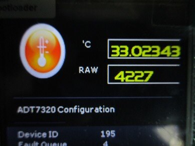

Step 04 - Read Temperature:
frames for reading temperature ->
     command byte  =  01010000 = 0x50 hex
C7
C6
C5
C4
C3
C2
C1
C1
0
R/W
Register address
0
0
0
0
1
0
1
0
0
0
0
Outputs at different temperatures:
For demonstration purpose I have used a very small range of temperature limits.
Normal Temperature [32 -33 'C] ->     The thermometer ICON stays green to indicate normal temperature.
Low Temperature [ < 32 'C] ->     The thermometer ICON becomes blue to indicate low temperature.
High Temperature [ 33 - 34 'C] -> The thermometer ICON becomes orange to indicate higher temperature.
Critically High Temperature [ > 34 'C ] ->      The thermometer ICON becomes red.

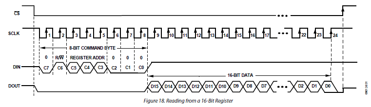

**these are the writing and reading structure of IDT7320 SPI protocol for both 8 and 16 bits taken from the datasheet.
Writing structure ->
                                                       8 bit
                                                       16 bit
Reading Structure ->
                                                          8 bit
                                                            16 bit
