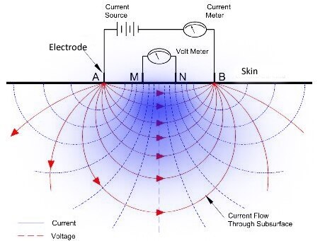

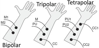

The basic principle of this technique is pretty simple. A limited current at certain frequency is passed through the body and the impedance is calculated by measuring the voltage output across the surface. Impedance varies inversely with water presence in the body tissue and electrolyte content, both of them depend on hydration. There are several techniques of measuring impedance ->
  • two electrode - bipolar
  • three electrode - tripolar
  • four electrode method - tetrapolar
Among them four electrode method is immune to contact impedance from the current injecting electrodes. Therefore, it gives better result and I am going to use it for my experiment.
The electrodes will be placed on back of the wrist.
** CC-> constant current carrier          PU -> potential measuring unit

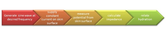

Basic Process:

For tetrapolar system, the sensitivity of the system depends on the distance between the electrodes.

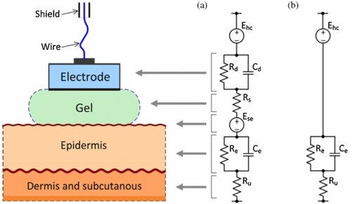

              Tetra-polar / Four Electrode System                                                                 Cole-Cole model of skin for (a) electrode impedance with gel     (b) dry electrode
The concentrated blue area represents the maximum sensitive zone.
The depth of that zone, Dsenmax = distance between electrodes / 3

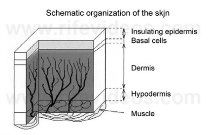

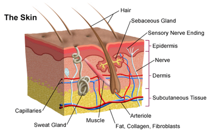

From the structure of the human skin, we can see that the sweat glands are at 'dermis' level. If we take a sensitive zone above the sweat glands then due to the heavy sweating during the game we'll get erroneous data. So, we must avoid the upper portion of the sweat glands [epidermis and dermis].
It means our region of interest is the level where we have the Subcutaneous Tissue. Any change of the ECW [extracellular water] and ICW [intracellular water] of the Subcutaneous tissues, will effect the impedance around that zone. So, impedance which is dominating at that zone can give us the hydration parameter.
Now, Epidermis is the thinnest on the eyelids at .05 mm and the thickest on the palms and soles at 1.5 mm.
Whereas,Dermis also varies in thickness depending on the location of the skin. It is .3 mm on the eyelid and 3.0 mm on the back.
So, the depth of the maximum sensitive zone should be about 5mm.
Which gives a minimum distance of electrodes = 5mm * 3 = 15mm.

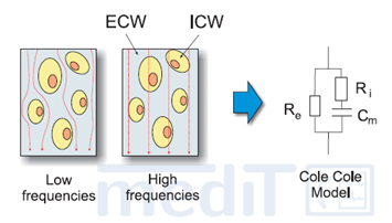

Frequency:

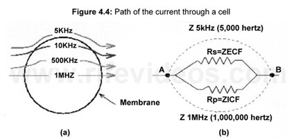

The frequency of the applied  current plays an important role on penetrating into the intracellular region. In general Low frequency [5KHz] cannot penetrate the cell membrane and passes through the extracellular zone. So, the ECW [extracellular water] will be dominating. On the other hand high frequency [1MHz] passes through the intracellular region, ICW [intracellular water] will be dominating. However, I am not sure whether it's better to select intracellular zone or extracellular zone for detecting potential dehydration.
For my preliminary experiment, I have selected lower frequency [oscillation up to 10KHz] as it's easier to implement. For higher frequency I need opamps with higher gain bandwidth which is expensive and will increase the circuit complexity.

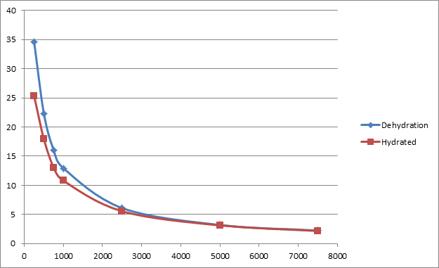

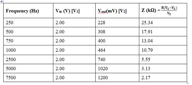

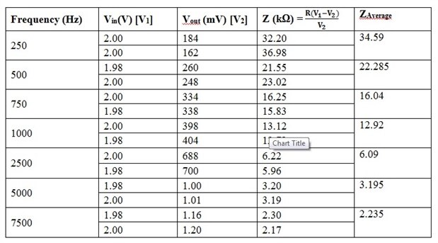

I have used a two electrode prototype circuit on breadboard to experiment the change of impedance due to hydration. My friend "Zisun A. Ayon" has helped me with this experiment on my request. We measured skin impedance value at various frequencies with a comparatively dehydrated state. After a few hours later, on the same day we took our measurement at comparatively hydrated state. We have found  change in skin impedance value as expected.
However, we have faced problem with electrode placement. As the impedance changes with the placement of the electrode. So, the electrode has to be place in the same way on the same spot.
I am presenting the rough data we have got from our first experiment -
**this was a very crude setup - just to check whether we get any variation of impedance or not. therefore, these data are not intended to use as any sort of reference. we need to take detail measurements on various subject and implement a four electrode system for a precise output.
Table 1: Measurement of skin contact impedance before Hydration;
where,Vin =2V p-p sine wave at a range of frequencies
            R=3.26 KΩ
Table 2: Measurement of skin contact impedance after Hydration;
R=3.26 KΩ

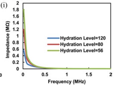

Plotting Measurement of Skin Contact Impedance Before and After Hydration -
The plot shows variation at lower frequencies. We compared this plot with a paper published on "Epidermal Impedance Sensing Sheets for Precision Hydration Assessment and Spatial Mapping". They had experimented with multiple capacitive electrode array at different frequencies to detect skin impedance variation with hydration. They had a higher frequency range and well tuned arrangement, but I just want to compare with their findings to get ensured that I am in the right path. Their plot for different frequencies at different hydration level shows the same shape of impedance variation.

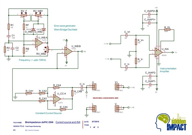

Circuit Diagram for Tetra-polar Measurement:
Wave generator - Wein Bridge oscillator [sine wave up to 10KHz] 1 - 2 Vp-p
Current source - Howland Constant Current Source at 1mA
Voltage measuring circuit - AD620 Instrumentation amplifier from Analog Device with high CMRR

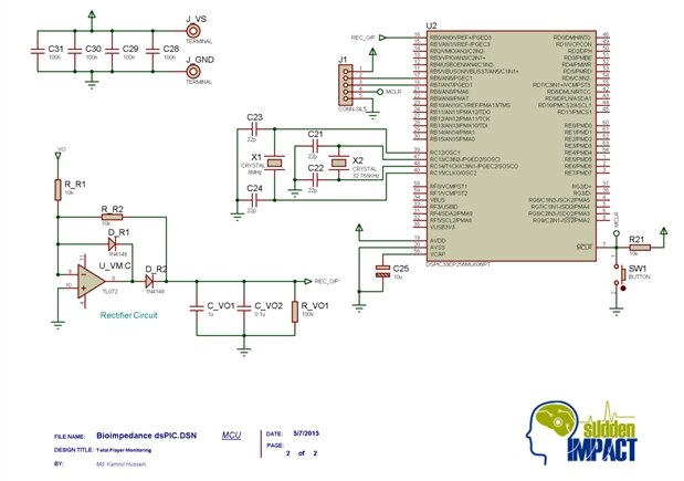

Further post processing of the signal is necessary like filtering and rectification to feed the output voltage into a microcontroller and calculate the impedance. The rectification can be done in hardware, whereas filtering and conditioning of the signal can be implemented in dsPIC33EP or PIC32 microcontroller.
