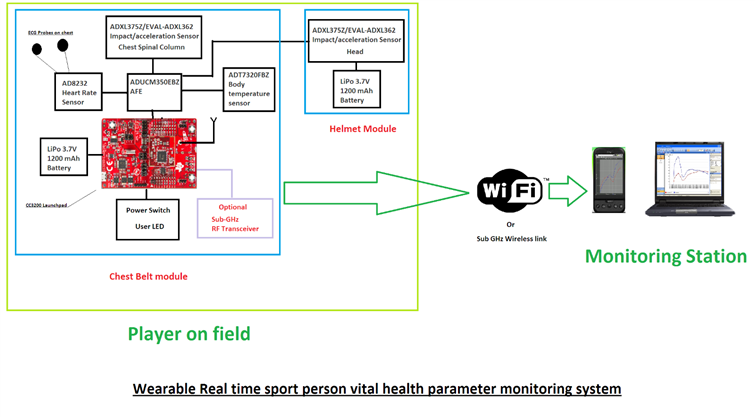

In my first blog post I would like to introduce my project proposal for your suggestions and feedbacks...
Project proposal: Designing of low cost and battery powered wearable sensor module to stream and monitor, vital body parameters of sport person on Android/IoS Smartphone and MacOS/Windows/Linux PC  using WiFi or on MacOS/Windows/Linux PC using long range Sub GHz transceiver at monitoring station.

High level block diagram of system is given below....image
