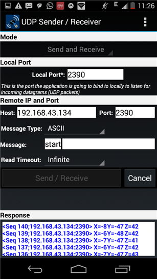

Once above energia sketch loaded on CC3200... I have Used my cell phone as hot spot to connect CC3200 sensor node and PC/Android cell phone(Remote monitoring Station)..
For testing received Data on Android phone I have used UDP Sender/Receiver android application available on google play store https://play.google.com/store/apps/details?id=com.jca.udpsendreceive&hl=en
Here is snapshot of received UDP packets on my android cell phone...

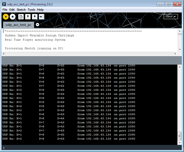

This is processing sketch for test UDP packets on PC running on (Linux/MAC/Windows)
Sudden Impact Wearable Design Challenge
Real Time Player monitoring System
Processing Sketch (running on PC)
Test Code for Wifi UDP connection between
Sensor node(CC3200 LaunchPad)and monitoring Station(Android cell phone / PC)
UDP Sender/Receiver Application used for Android cell phone
Processing application for use with PC (Linux/MacOS/Windows)
BMA222 Library used for CC3200 Launchpad on board Accelerometer interface
created 13 December 2014
by Ravi Butani
 e-mail: ravi_butani@yahoo.com
Attribute : Cousot stephane for The Atelier Hypermedia
            http://hypermedia.loeil.org/processing/
Code released under CC-SA  2014 license
// import UDP library
import hypermedia.ne.*;
UDP udp;  // define the UDP object
* init
void setup() {
  // create a new datagram connection on port 6000
  // and wait for incomming message
  udp = new UDP( this, 2390 );
  udp.listen( true );
//process events
void draw() {
    String message  = "hii";  // the message to send
    String ip      = "192.168.43.134";  // the remote IP address
    int port        = 2390;    // the destination port
    // formats the message for Pd
    message = message+";\n";
    // send the message
    udp.send( message, ip, port );
    while(true)
* To perform any action on datagram reception, you need to implement this
* handler in your code. This method will be automatically called by the UDP
* object each time he receive a nonnull message.
* By default, this method have just one argument (the received message as
* byte[] array), but in addition, two arguments (representing in order the
* sender IP address and his port) can be set like below.
// void receive( byte[] data ) { // <-- default handler
void receive( byte[] data, String ip, int port ) { // <-- extended handler
  // get the "real" message =
  // forget the ";\n" at the end <-- !!! only for a communication with Pd !!!
  data = subset(data, 0, data.length);
  String message = new String( data );
  // print the result
println( "UDP Rx: "+message+"\t from "+ip+"\t on port "+port );
and here is the result of received UDP Packets on my PC...
