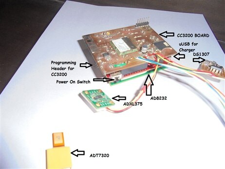

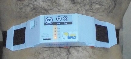

With Continuation to my Previous Post.. where I have shared all GUI Related codes and executable application, In this post I am Sharing My Hardware Details and mcu Source codes in open source domain...

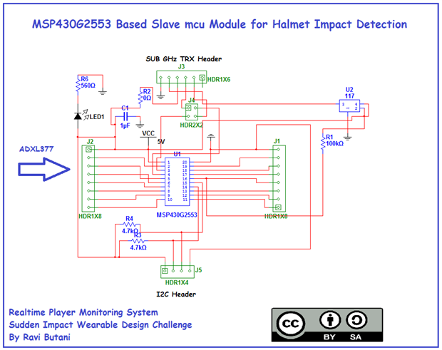

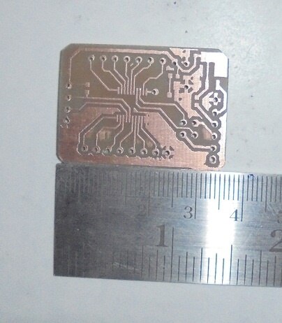

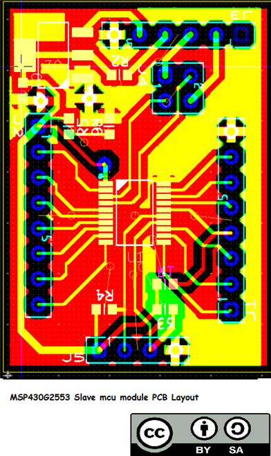

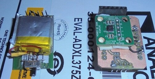

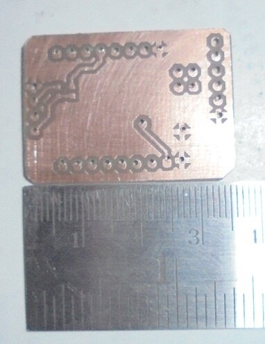

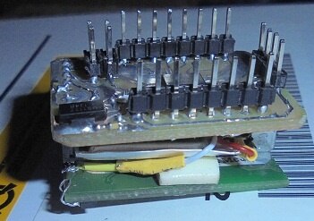

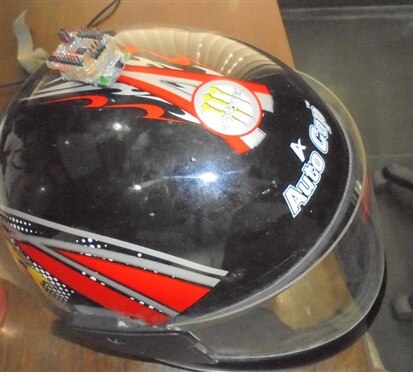

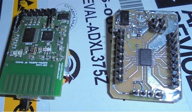

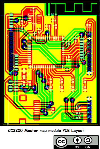

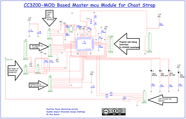

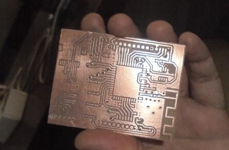

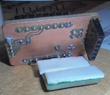

1. Hardware Schematics, Hardware Details and PCB Layout

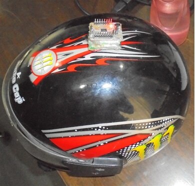

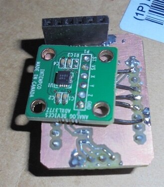

1.1 Schematic of CC3200-MOD based Master mcu Module for Chest Strap:
1.2 Schematic of MSP430 Slave mcu module for Halmet Impact Detection :
2. Source code of mcu MSP430 and CC3200
2.1 CC3200-mod Master mcu Source code : Source compiled with energia-0101E0015
  Sudden Impact Wearable Design Challenge
  Project : Real Time Player Monitoring System
  Sponsered By element14 , Analog Devices, Tektronix and Electrolube
  Special Thanks to Texas Instruments for providing CC3200MOD, MSP430, TLV3402 Samples free of cost
  You can Track Progress of this project at..
  http://www.element14.com/community/community/design-challenges/sudden-impact/blog/2014/12/31/realtimemonitor-real-time-player-monitoring-system-table-of-contents
  Source code for Master MCU (CC3200)
  Interfaces :
  1. Two ADXL375 interface via i2c
  2. Micro-SD card interface via SPI
  3. Slave MCU (MSP430G2553)/SUB GHz TRx interfaced via UART
  4. ADT7320 Temp Sensor Interfaced via bit bangging SPI
  5. AD8232 Based Heart Rate monitor interfaced on Digital Pin with interrupt
  6. DS1307 RTC Interfaced on I2C Bus
  Target MCU : TI CC3200 or CC3200MOD
  By: Ravi Butani
  Date:29th April,2015
  e-mail: ravi_butani@yahoo.com
  Source Code is Released Under Creative Commons Attribution-ShareAlike 3.0 Unported Licence

2.2 MSP430 Slave mcu Source Code: Source compiled with energia-0101E0015
  Source code for Slave MCU (MSP430G2553)
  Interfaces :
  1. Two ADXL377 interface via A3,A4,A5
  2. SUB GHz TRx interfaced via UART
  Target MCU : TI MSP430G2553
  By: Ravi Butani

    ravi_butani over 11 years ago in reply to gsgill112 +2
    The green wire comes from back of CC3200 Launchpad is reset wire... Black is GND Green Wire on Top of CC3200 Launchpad is TCK Orange and yellow is TX RX... As I have powered CC3200MOD from LiPo Battery…

    If ur PCB HV solder mask than its too easy else it is bit tricky...cc3200 mod is not much sensitive to solder temperature profile so if you mk any mistake it not going to fry or fail...
  • tomaja
    tomaja over 11 years ago in reply to ravi_butani
    My CC3200MOD is on it's way image
    Was it hard to solder?
    Thanks,
    Dragan
