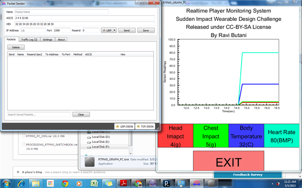

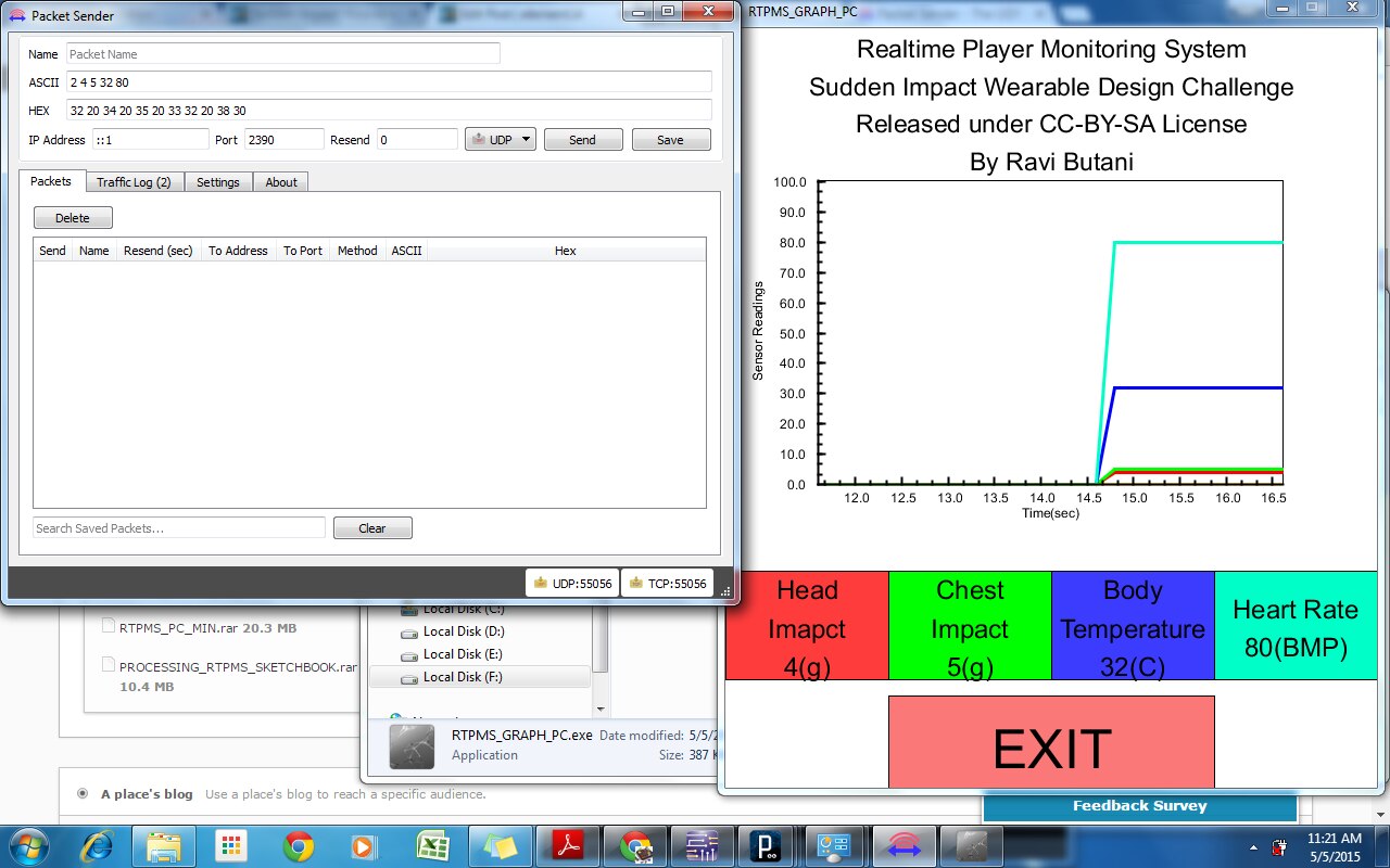

  g.addTrace(r5);
  g.position.y = height/5;
  g.position.x = width/7;
  g.setYAxisTickSpacing(10);
  g.setXAxisMax(5f);
  g.setXAxisLabel("Time(sec)");
  g.setYAxisLabel("Sensor Readings");
   delay(50);
void draw(){
  background(255);
  g.draw();
   textSize(23);
   textAlign(CENTER, CENTER);
   fill(0);
   text("Realtime Player Monitoring System\nSudden Impact Wearable Design Challenge\nReleased under CC-BY-SA License\nBy Ravi Butani", width/2, height/12+10);
   textSize(24);
   if (acc1_flag == 1)fill(color(255,60,60));
   else fill(color(160,160,160));
   rect(0, 5*height/7, width/4, height/7);
   fill(0);
   text("Head\nImapct\n"+acc1+"(g)", width/8, 5*height/7+height/14);
   if (acc2_flag == 1)fill(color(0,255,0));
   rect(width/4, 5*height/7, width/4, height/7);
   fill(0);
   text("Chest\nImpact\n"+acc2+"(g)",width/4+width/8, 5*height/7+height/14 );
   if (temp_flag == 1)fill(color(60,60,255));
   rect(2*width/4, 5*height/7, width/4, height/7);
   fill(0);
   text("Body\nTemperature\n"+temp+"(C)",2*width/4+width/8, 5*height/7+height/14);
   if (hret_flag == 1)fill(color(0,255,200));
   rect(3*width/4, 5*height/7, width/4, height/7);
   fill(0);
   if(hret == 0) {text("Heart Rate\nLeads Off", 3*width/4+width/8, 5*height/7+height/14);}
   else {text("Heart Rate\n"+hret+"(BMP)", 3*width/4+width/8, 5*height/7+height/14);}
   fill(color(250,120,120));
   rect(width/4, 6*height/7+15, width/2, height/7-15);
   fill(0);
   textSize(50);
   text("EXIT", width/2, 6*height/7+height/14+8);
void receive( byte[] data, String ip, int port ) {  // <-- extended handler
  data = subset(data, 0, data.length);
  String inString = new String( data );
   if (inString != null) {
  udp_log.println(hour()+":"+minute()+":"+second()+ " " + inString);
  int[] nums = int(split(inString, ' '));
  pid = nums[0];
  acc1 = nums[1];
  acc2 = nums[2];
  temp = nums[3];
  hret = nums[4];
  ecg = nums[5];
print(nums[0]);
print("\t");
print(nums[1]);
print("\t");
print(nums[2]);
print("\t");
print(nums[3]);
print("\t");
print(nums[4]);
print("\t");
println(nums[5]);
void mousePressed()
if(mouseY > 5*height/7 && mouseY < 6*height/7)
   if(mouseX > 0 && mouseX < width/4)
   if(acc1_flag == 1)acc1_flag=0;
   else acc1_flag = 1;
   if(acc1_flag == 1) r1.setTraceColour(255, 0, 0);
   else r1.setTraceColour(255, 255, 255);
   else if(mouseX > width/4 && mouseX < 2*width/4)
   if(acc2_flag == 1)acc2_flag=0;
   else acc2_flag = 1;
   if(acc2_flag == 1) r2.setTraceColour(0, 255, 0);
   else r2.setTraceColour(255, 255, 255);
   else if(mouseX > 2*width/4 && mouseX < 3*width/4)
   if(temp_flag == 1)temp_flag=0;
   else temp_flag = 1;
   if(temp_flag == 1) r3.setTraceColour(0, 0,255);
   else r3.setTraceColour(255, 255, 255);
   else if(mouseX > 3*width/4 && mouseX < width)
   if(hret_flag == 1)hret_flag=0;
   else hret_flag = 1;
   if(hret_flag == 1) r4.setTraceColour(0, 255, 255);
   else r4.setTraceColour(255, 255, 255);
  if(mouseY > 6*height/7 && mouseY < 7*height/7 && mouseX > width/4 && mouseX < 3*width/4)
  udp_log.flush(); // Writes the remaining data to the file
  udp_log.close(); // Finishes the file
   exit();

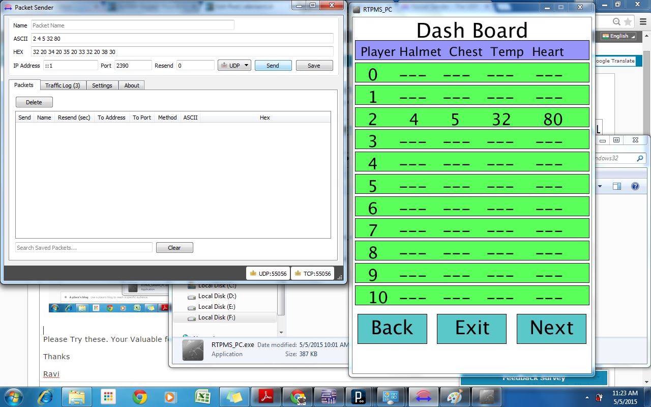

void draw_frame0() //main frame
   background(bg_frame0);
   pushStyle();
   textSize(42);
   if(game_type == 0)fill(color(255,90,90));
   else fill(160);
   rect(width/4, height/2, width/4, 80);
   fill(0);
   pushStyle();
   textSize(34);
   text("Single", width/4+width/8, height/2+32 );
   text("Player", width/4+width/8, height/2+68 );
   popStyle();
   if(game_type == 1)fill(color(255,90,90));
   else fill(160);
   rect(width/2, height/2, width/4, 80);
   fill(0);
   pushStyle();
   textSize(34);
   text("Multi", width/2+width/8, height/2+32 );
   text("Player", width/2+width/8, height/2+68 );
   popStyle();
   fill(color(90,200,200));
   rect(10, 5*height/6, width/3-20, height/12);
   fill(0);
   text("About", width/6, 5*height/6 + height/12-24 );
   rect(width/3+10, 5*height/6, width/3-20, height/12);
   fill(0);
   text("Exit", 3*width/6, 5*height/6 + height/12-24 );
   rect(2*width/3+10, 5*height/6, width/3-20 , height/12);
   fill(0);
   text("Next", 5*width/6, 5*height/6 + height/12-24);
   popStyle();

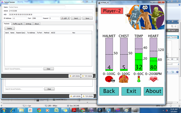

void draw_frame2()//monitor window
   background(bg_frame1);
   pushStyle();
   textSize(35);
   if(activity_flag[player_id_show] == 0)fill(color(255,90,90));
   else fill(color(130,130,255));
   rect(20,20,width/3,height/16);
   fill(0);
   text(Player1+player_id_show,20+width/6, height/16);
   popStyle();
   fill(color(200,180,210));
   rect(width/9, height/3, width/9, height/3);
   if(h_acc > h_acc_TH) fill(color(255,50,50));
   else fill(color(0,255,0));
   rect(width/9, 2*height/3 - map(h_acc,0,100,0,height/3) , width/9, map(h_acc,0,100,0,height/3));
   fill(0);
   text("HALMET", width/9 + width/18, height/3 - 5 );
   pushStyle();
   textSize(42);
   text(h_acc,width/9 + width/18, 2*height/3 - 10);
   popStyle();
   textAlign(LEFT);
   text("_______"+h_acc_TH, width/9 , 2*height/3 - map(h_acc_TH,0,100,0,height/3));
   textAlign(CENTER);
   text("0-100G",width/9 + width/18, 2*height/3 + 35);
   rect(3*width/9, height/3, width/9, height/3);
   if(b_acc > b_acc_TH) fill(color(255,50,50));
   rect(3*width/9, 2*height/3 - map(b_acc,0,100,0,height/3) , width/9, map(b_acc,0,100,0,height/3));
   fill(0);
   text("CHEST", 3*width/9 + width/18, height/3 - 5 );
   pushStyle();
   textSize(42);
   text(b_acc,3*width/9 + width/18, 2*height/3 - 10);
   popStyle();
   textAlign(LEFT);
   text("_______"+b_acc_TH, 3*width/9 , 2*height/3 - map(b_acc_TH,0,100,0,height/3));
   textAlign(CENTER);
   text("0-100G",3*width/9 + width/18, 2*height/3 + 35);
   rect(5*width/9, height/3, width/9, height/3);
   if(b_tmp > b_tmp_UTH) fill(color(255,50,50));
   else if(b_tmp < b_tmp_UTH && b_tmp > b_tmp_LTH) fill(color(0,255,0));
   rect(5*width/9, 2*height/3 - map(b_tmp,0,60,0,height/3) , width/9, map(b_tmp,0,60,0,height/3));
   fill(0);
   text("TEMP", 5*width/9 + width/18, height/3 - 5);
   pushStyle();
   textSize(42);
   text(b_tmp, 5*width/9 + width/18, 2*height/3 - 10);
   popStyle();
   textAlign(LEFT);
   text("_______"+b_tmp_UTH, 5*width/9 , 2*height/3 - map(b_tmp_UTH,0,60,0,height/3));
   text("_______"+b_tmp_LTH, 5*width/9 , 2*height/3 - map(b_tmp_LTH,0,60,0,height/3));
   textAlign(CENTER);
   text("0-60C",5*width/9 + width/18, 2*height/3 + 35);
   rect(7*width/9, height/3, width/9, height/3);
   if(h_ret > h_ret_UTH) fill(color(255,50,50));
   else if(h_ret < h_ret_UTH && h_ret > h_ret_LTH) fill(color(0,255,0));
   rect(7*width/9, 2*height/3 - map(h_ret,0,200,0,height/3) , width/9, map(h_ret,0,200,0,height/3));
   fill(0);
   text("HEART", 7*width/9 + width/18, height/3 - 5 );
   pushStyle();
   textSize(42);
   text(h_ret, 7*width/9 + width/18, 2*height/3 - 10);
   popStyle();
   textAlign(LEFT);
   text("_______"+h_ret_UTH, 7*width/9 , 2*height/3 - map(h_ret_UTH,0,200,0,height/3));
   text("_______"+h_ret_LTH, 7*width/9 , 2*height/3 - map(h_ret_LTH,0,200,0,height/3));
   textAlign(CENTER);
   text("0-200BPM",7*width/9 + width/18, 2*height/3 + 35);
   if(leads_off_flag == 1)
   fill(color(0,0,0));
   pushStyle();
   textSize(42);
   fill(0);
   text("Back", width/6, 5*height/6 + height/12-24 );
   fill(0);
   fill(0);
   text("About", 5*width/6, 5*height/6 + height/12-24);
   popStyle();

Testing of PC Application in Stand Alone Mode..
I have usd https://packetsender.com/ and Packet format in ascii is ..
Player_id Head_acc Body_Acc Body_Temp Heart_Rate (Each Separated With single Space)
e.g. 2 3 5 34 78
Port is 2390
Communication is UDP
ipaddress : localhost or ::1
Note all application uses same port 2390 so on a system only one can run at a time.. on mutiple system multiple can run at a time..
