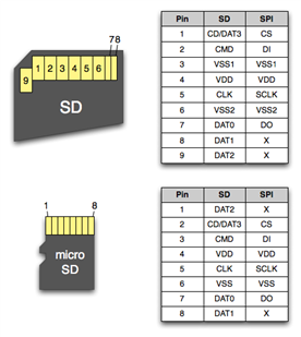

Here is Pin out os SD and microSD Card for quick reference...

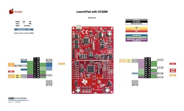

CC3200 LaunchPad Pin out for energia is below..
(image:http://energia.nu/wordpress/wp-content/uploads/2014/09/cc3200lppinmap.jpg)

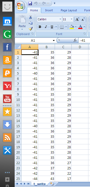

After all this test, I have converted *.txt file, written by cc3200 Launchpad on SDCard  to *.csv file and here is screen shot of the results.. As now all data in *.csv, format it can be used for create informative graphs...

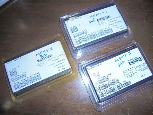

This all about this week ... I have found this ADXL377 and ADXL345 free samples (By ADI) from my work place...
Mean while I receive parts as part of this challenge I am planning to interface this Accelerometers with CC3200 in next days..
